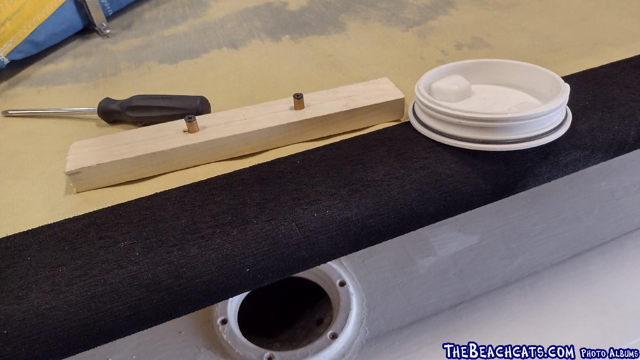

  • Here is what I did. Simple tool - piece of wood, a couple of bushings, and a couple of screws.
    https://www.thebeachcats.com/gallery2/main.php?g2_view=core.DownloadItem&g2_itemId=135848&g2_serialNumber=3

  • waiex191Here is what I did. Simple tool - piece of wood, a couple of bushings, and a couple of screws.

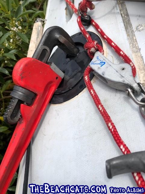

    I needed more leverage to open a deck port last weekend and thought of this suggestion. Then I looked for something more at hand and this worked perfectly :)
    https://www.thebeachcats.com/gallery2/main.php?g2_view=core.DownloadItem&g2_itemId=135922&g2_serialNumber=3
