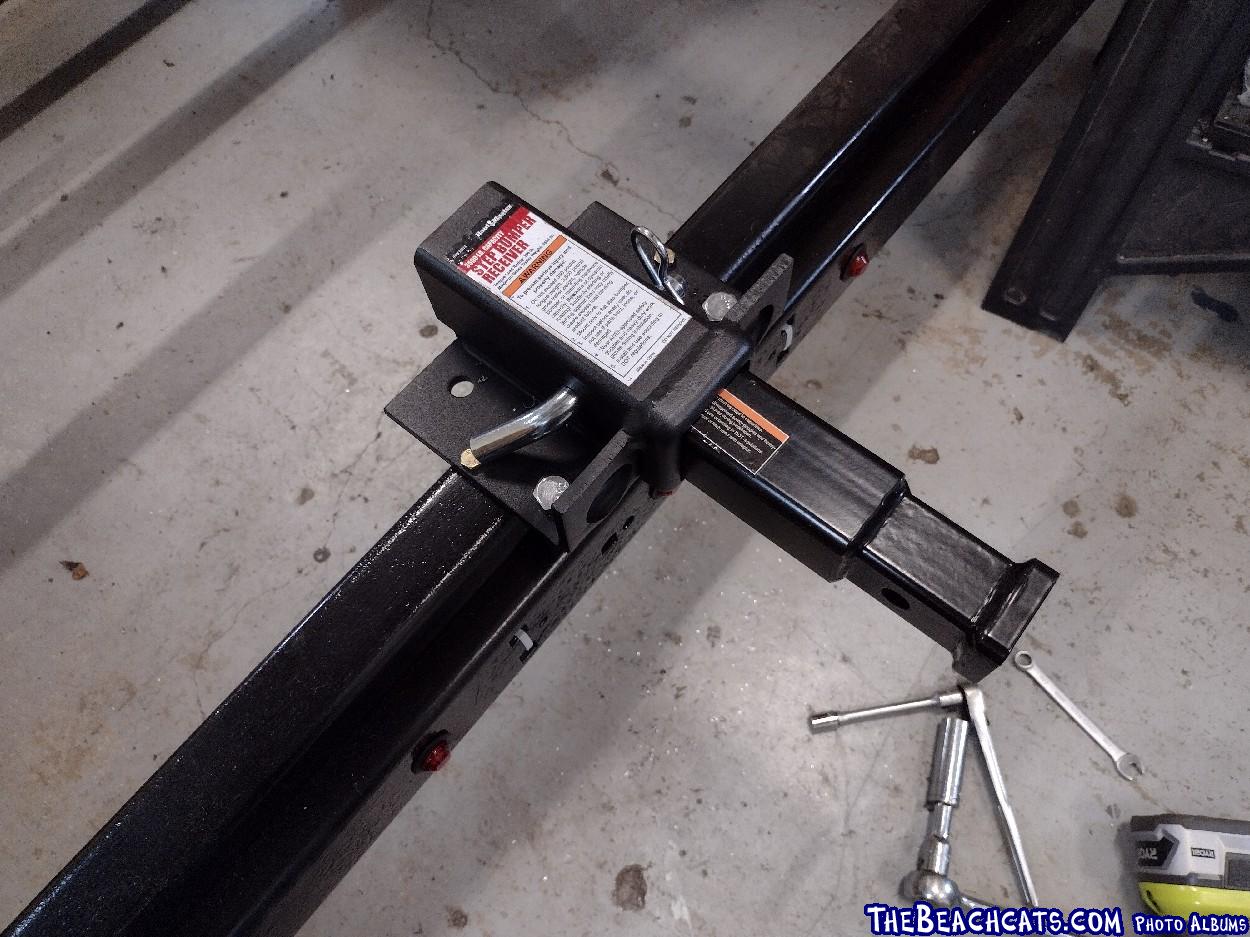

  • I bought a trailer hitch, and a 2" to 1.25" adapter to make one.
    https://www.thebeachcats.com/gallery2/main.php?g2_view=core.DownloadItem&g2_itemId=135842&g2_serialNumber=3
    Hitch: https://www.harborfreight…mper-receiver-69673.html
    Adapter: https://www.harborfreight…hitch-adapter-65024.html

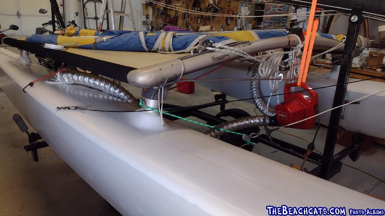

    I welded my mast support onto the adapter. You can see it to the right of the red blower.
    https://www.thebeachcats.com/gallery2/main.php?g2_view=core.DownloadItem&g2_itemId=135843&g2_serialNumber=3
    I used a rubber bow stop on top of the support:
    https://www.amazon.com/gp…asin_image?ie=UTF8&psc=1
    I drilled a couple of extra holes in the hitch adapter so I can mount it sideways, which lays down the mast support out of the way.
    Bryan in Poplar Grove, IL
