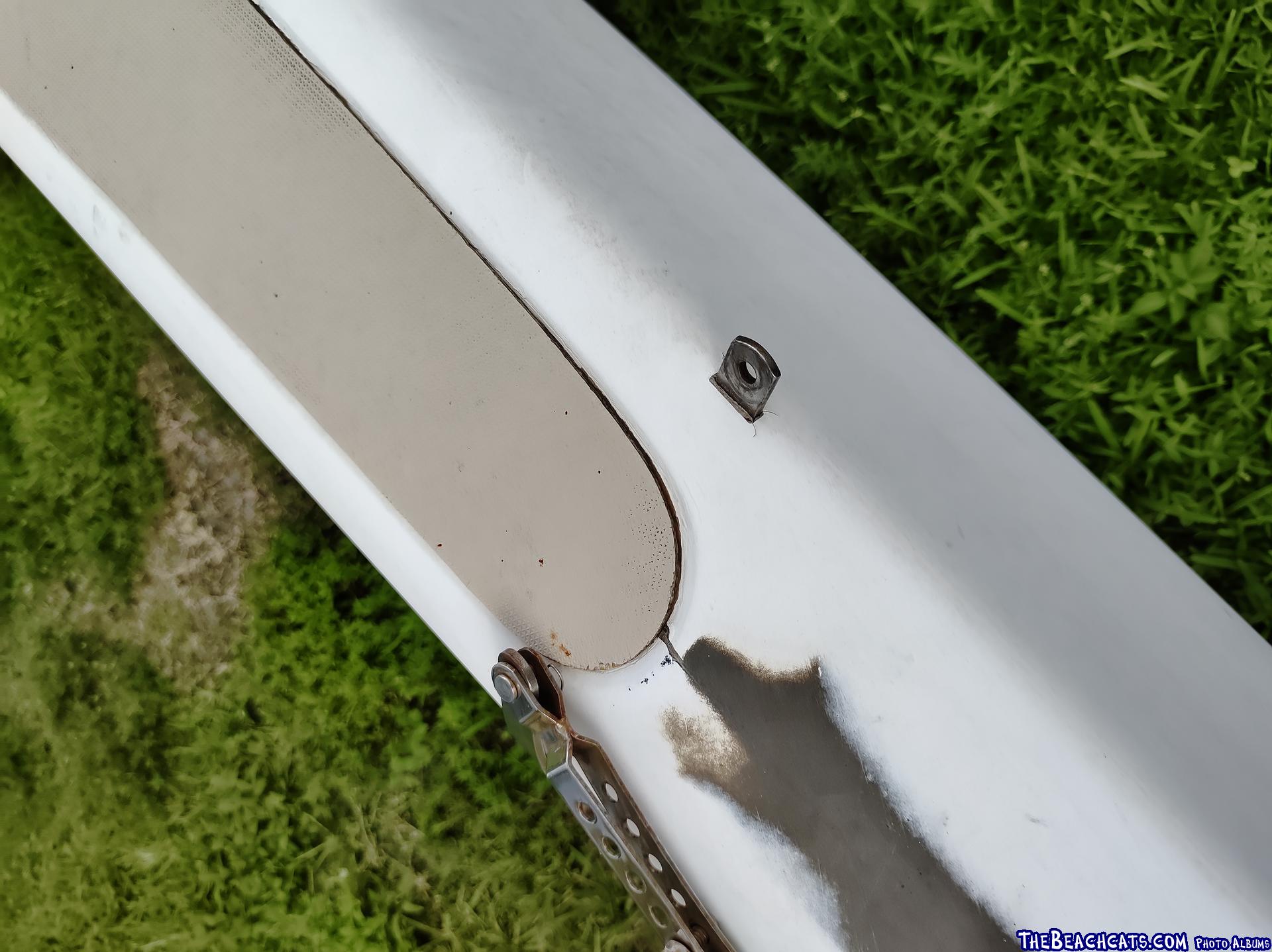

  • So... I bought a "project" and realized that it has a broken port hull chainplate for the jib. I contacted Murray Sports to purchase one, and was told that they don't make it anymore. Groan. So where would I scavenge one? (I'm trying to upload image and can't).

  • The forestay bridle chainplates are accessible and repairable by opening the top-deck at the bow. The part you need is here: https://www.h2o-sensation…-vorm-2000000001951.html This thread discusses the same failure in a N 5.5. https://www.thebeachcats.…ms/viewtopic/topic/18322
  • Heres the problem:
    https://www.thebeachcats.com/pictures?g2_itemId=135370
    https://www.thebeachcats.com/pictures?g2_itemId=135366
    tominpa, I don't think that chainplate is the same. The bend is different.

  • It looks like you have a secod attachment bow tang on the outside of the hull? is that correct?
  • Yes. TBH, I'm not even sure of the rigging. Anyone have a detailed picture of the way it's supposed to be rigged? I've never rigged much less sailed a Nacra yet
  • MN3It looks like you have a secod attachment bow tang on the outside of the hull? is that correct?
    MN3, so I've managed to look at the rigging on some other Nacra 5.7. So I guess somewhere the previous owner broke the chainplate, then instead of fixing it, just put the 2nd bow tang on each hull instead. Hmm.
  • My 5.7 only has the inboard bow tang on both sides with a single hole that attaches to a bridle wire and connects to a 1/2 twist shackle then to a chainplate like the one in your image attached to the outside of the hull. Someone really modified your boat! Let me know if you want some close-up images of this forestay rig, but your port hull is correct except the bridle should connect to that inboard tang, not the chainplate, the starboard, not so much.

  • MN3, I have not had to repair the bridle wire tangs on my boat, so I don't know exactly what to expect if I open the top, but that would tell the tale. The images in your post are not even close to what I see on mine.

  • Tom is correct, you should only have a single hole, in a small tang, on the INBOARD side of the bow,
    If the age of the rigging is unknown, I would have a new set of wires made.
    Spend the extra few $ & have them made with marine forks on one end. Then you simply pin the fork to that short bow tang, eliminating all shackles.
    You can use a simple loop on the other end, without twist shackles. Just pin a bow shackle to the single hole of a 10 hole adjuster, (allows for variable mast rake). The loops of the bridal wires are captive in the bow shackle.
    However, if you intend to add roller furling to your jib, (highly recommended), make both ends of the bridals marine forks. This allows the use of a single triangle plate to attach bridals to the furling drum.
    See the photo Portuguese Turnbuckle in this album.
    If you are getting new rigging made, have the forestay made 3.5” shorter than stock, with a pigtail at one end.
    The furling drum & swivel will make up for the shortened forestay
