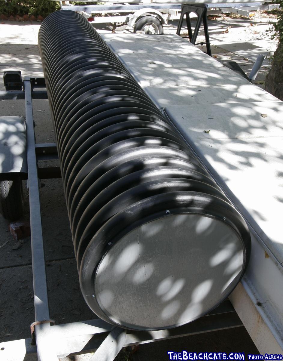

  • here's what i did. it's double-walled and smooth inside. the locking mechanism isn't bullet proof of course but a deterrent, but then what sailbox is impossible to break into?
    j
    HDPE pipe
    15" or 18" x 20ft HDPE pipe can be purchased at Menards & other Big-Box stores. Mine cost $162 so when I cut it in half each tube was $80. Light weight and water proof. ends are painted plywood.
