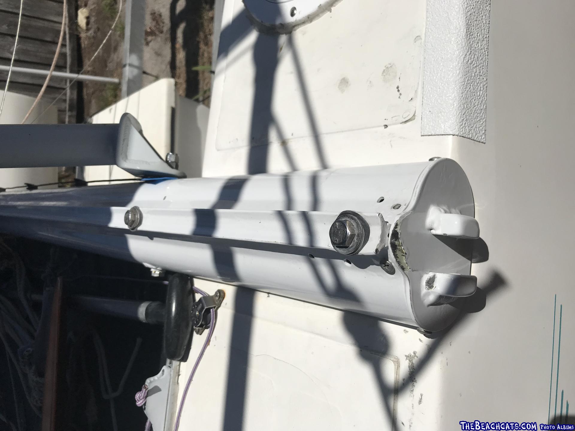

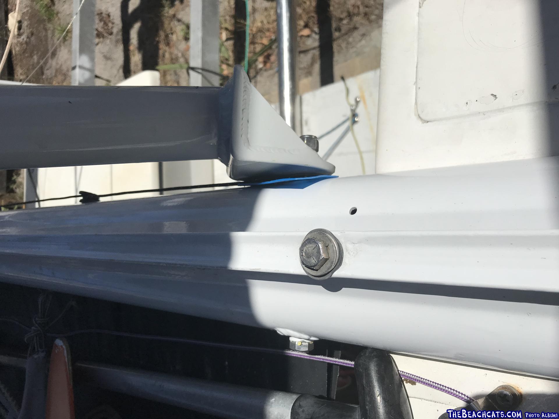

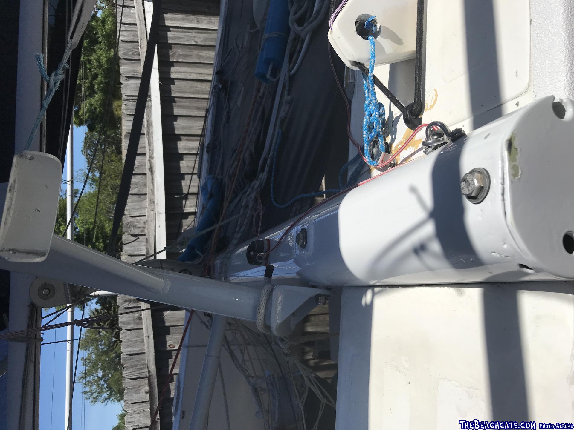

also since your beams have no end caps, and have springs and levers for assembly right there you (at the beam end) would need a different solution than the nacra style wings that actually go into the beam -

I was thinking for the rear support, drill through the beam support and tap bolts directly into the aluminum beam. The forward part could hook into the aluminum channel attached to the deck/hull-deck joint
