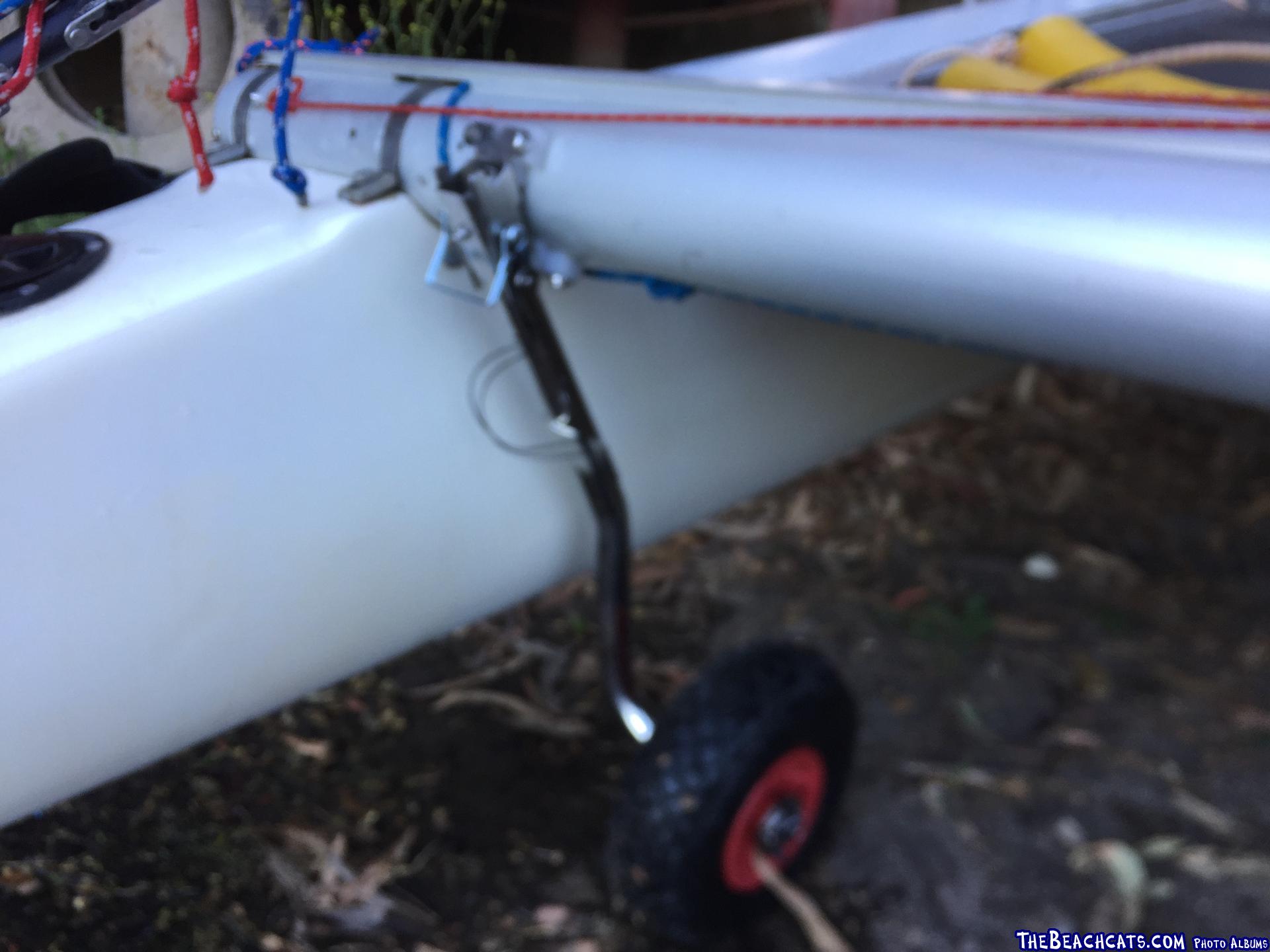

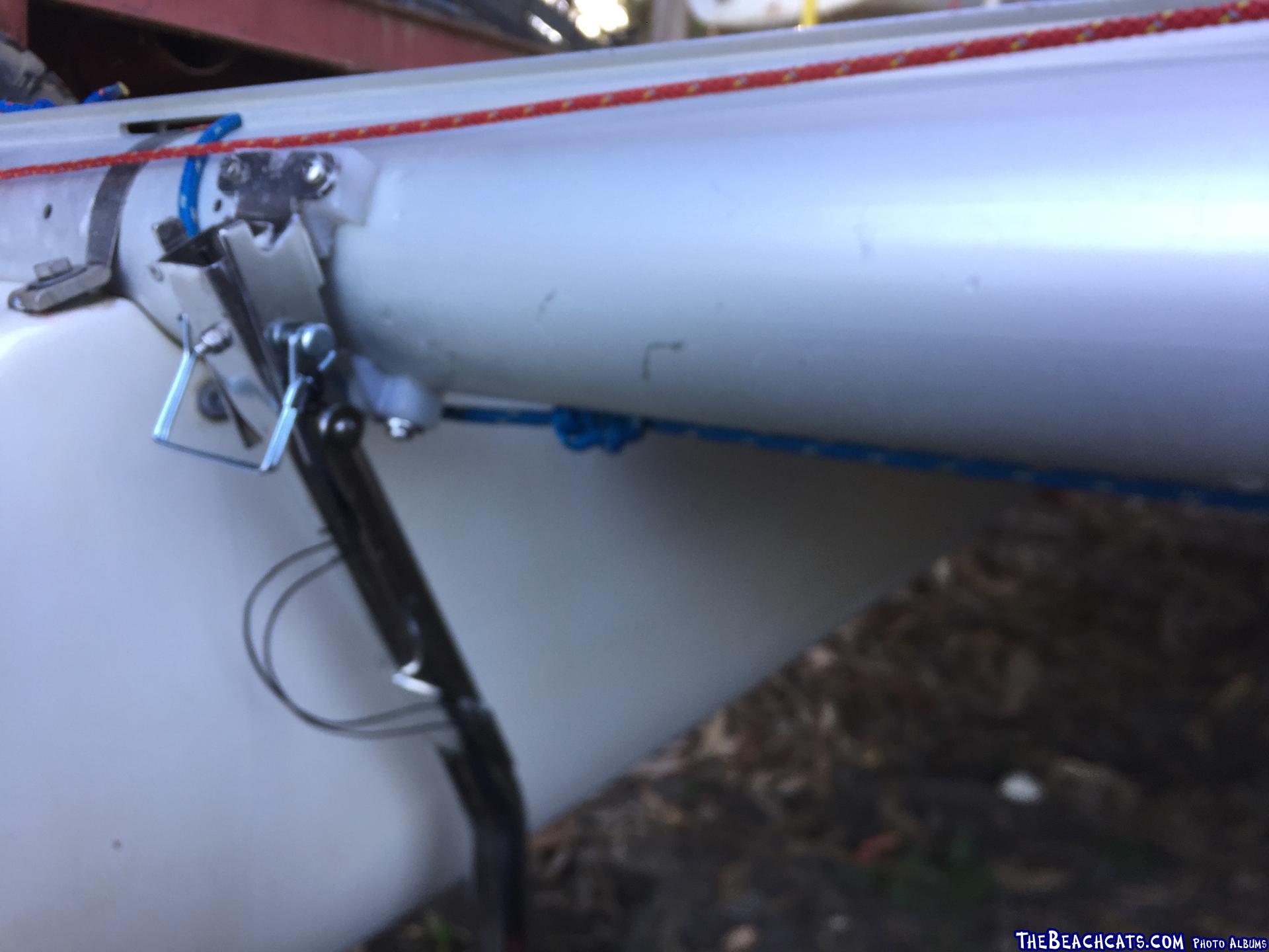

  • charlescarlisWould love to see a video of someone transferring a 21 between the trailer and the Trax. I mean, is it hard to put one of these large cats on Trax???
    I do that very often so I optimized it. My boat is smaller (n5.5) but it should work:
    Changed the rear cradles of the trailer for double rollers. Big difference.
    Then I adapted a couple Zodiak wheels that make it possible to slide the boat in and out without having to hold it at the sterns,just slide it. I use the trailer winch tu pull it in
    https://www.thebeachcats.com/gallery2/main.php?g2_view=core.DownloadItem&g2_itemId=130726&g2_serialNumber=3
    https://www.thebeachcats.com/gallery2/main.php?g2_view=core.DownloadItem&g2_itemId=130725&g2_serialNumber=3
