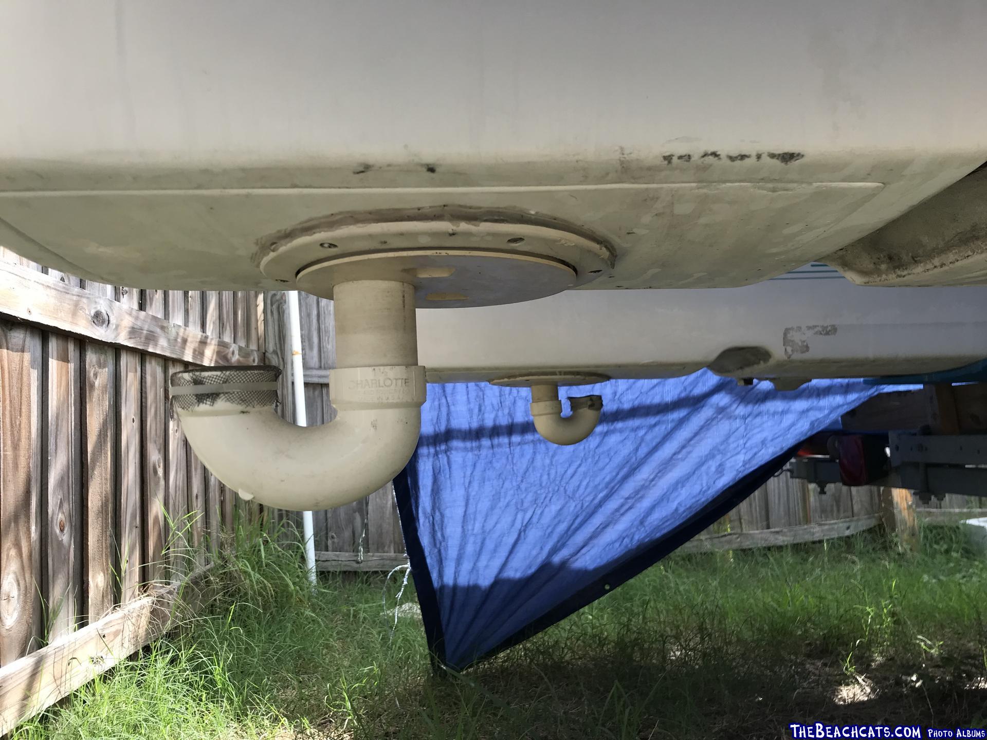

    i took old hatch covers and drilled a 2" hole in it. attached a pvc u with a small straight pvc pipe (that connects the u to the hatch-cover), covered the open end with some patio screening so bugs can't get in. this will allow ventilation and keep critters out

  • Quotei took old hatch covers and drilled a 2" hole in it. attached a pvc u with a small straight pvc pipe (that connects the u to the hatch-cover), covered the open end with some patio screening so bugs can't get in. this will allow ventilation and keep critters out
    https://www.thebeachcats.com/gallery2/main.php?g2_view=core.DownloadItem&g2_itemId=131042&g2_serialNumber=3
    the p-trap is to keep rain out (not really an issue in their current position)
    i have other ones where i just drilled holes and glued patio screen on top of it
