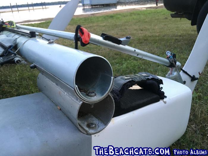

  • flightlead:
    I've uploaded this image to the Beachcats Technical Album (https://www.thebeachcats.…ictures?g2_itemId=131055):
    https://www.thebeachcats.com/gallery2/main.php?g2_view=core.DownloadItem&g2_itemId=131059&g2_serialNumber=4
    It's a friend's Bimare F18HT, but he didn't build the beam mod....it came off another boat. As I understand it, the previous owner of the beam had it fabbed, but I don't know if it was his design or from some other source.
    Hopefully this will give you some ideas for your solution.

  • rattlenhumflightlead:
    thanks Rattlehum
