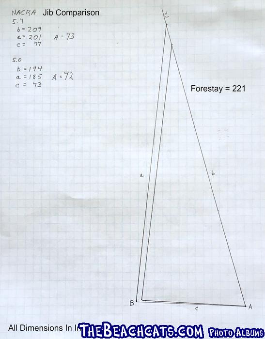

    Looks like you've done the measuring for me. I don't have a roller furler. Looks like it would take a minimum of 17" free forestay to nominally fit. Will have to measure the amount free to know for sure next time I have the boat up.

  • Edchris177I think you will run out of room, especially if you have roller furling on the 5.0. The jib already comes close to the top swivel. The 5.7 is at least a foot longer.
    I laid it all out to scale and yes, I will likely have to relocate the the jib halyard block to the forestay attachment point, but it looks like it will fit. My M25 was rigged with the halyard block at the forestay attachment point and I liked that geometry as it tensions the jib luff more squarely along the forestay rather than pulling it off towards the mast. I may also have to move the jib sheet blocks, but no worry, easy to do. No matter what this will be fun...film at 11.

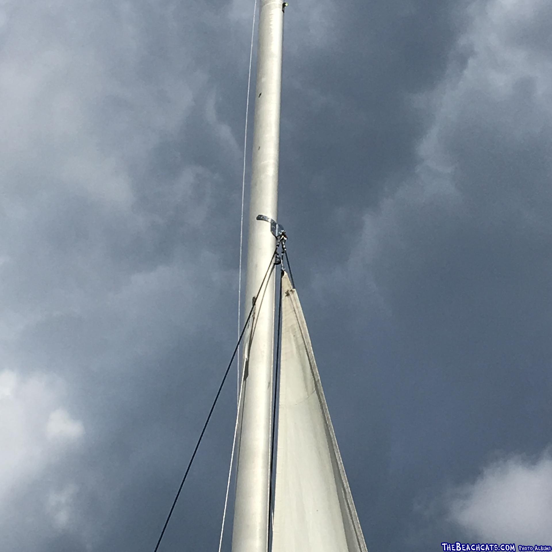

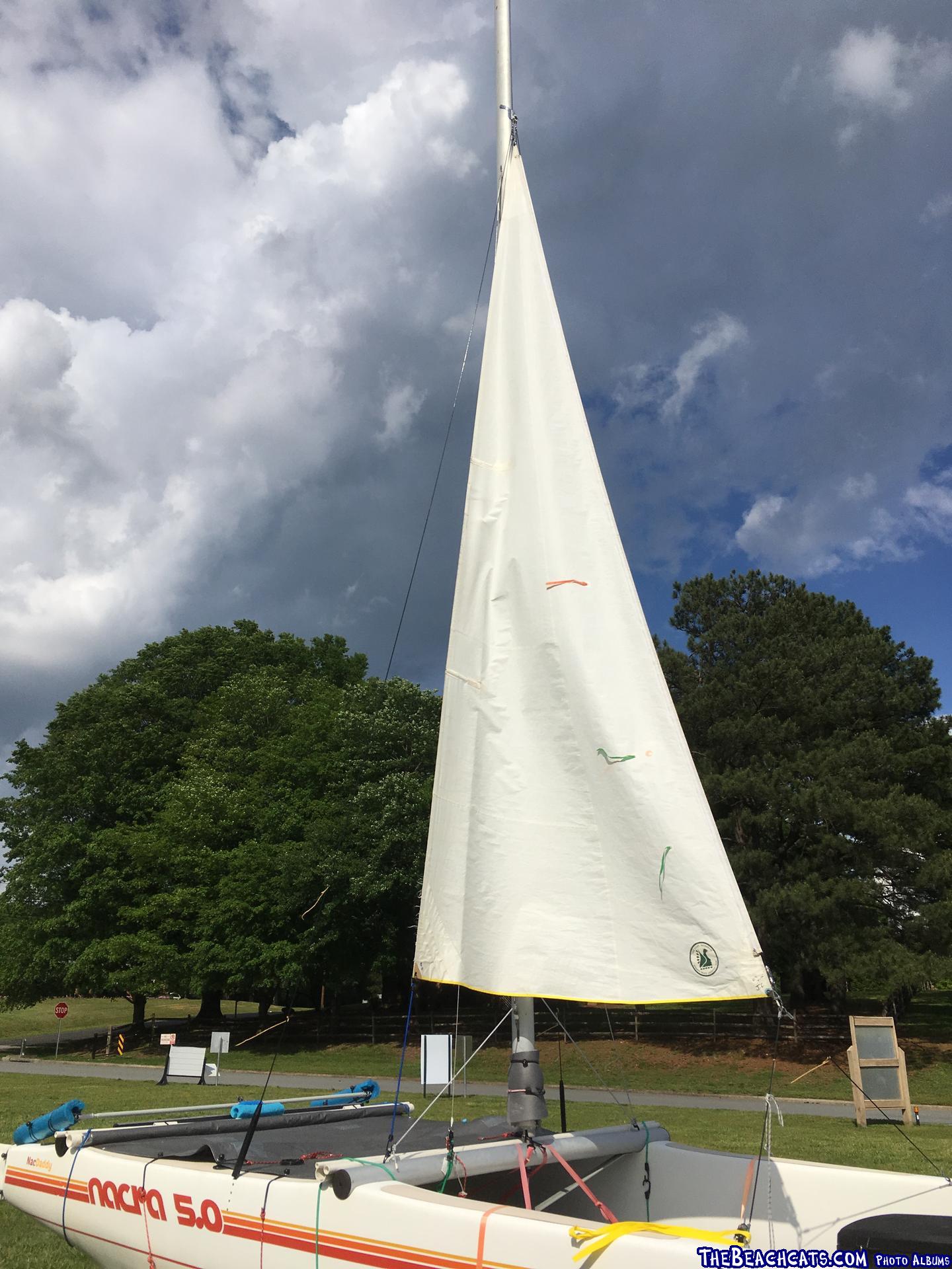

    Here are a couple of progress pics so far, moving pretty slow on this one. My intention was to try a Nacra 5.7 jib which according to everything I have found thus far should be 209, 201, 77. I bought a sail advertised as a 5.7 jib, but it actually measures corner to corner under light staked out on the ground tension 215, 207, 77 (note I'm not complaining as it was a bargain basement purchase just to try this). Even at 215 it fits with about 7 inches of forestay left (an actual 5.7 jib at 209 would for sure fit). The problem is that the jib halyard block is mounted to the mast so low that you run out of space for downhauling sufficiently. To solve this problem my next step is to mount a Shock Block on the tang at the hounds then give it a go in the water after moving the jib blocks if needed to get equal leech/foot tension as a starting poing. Cheers
