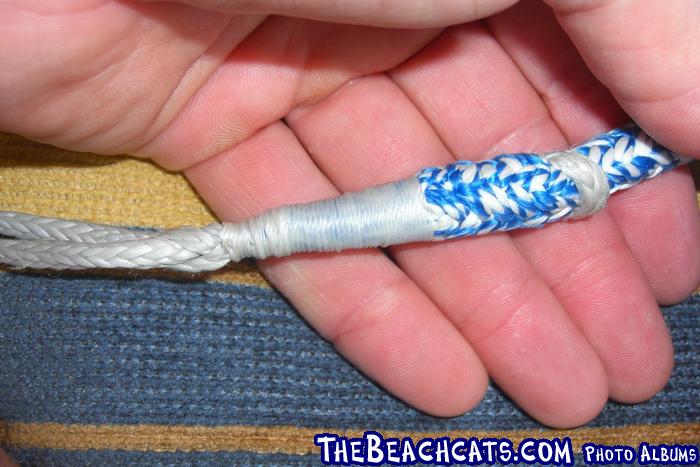

  • For 10:1
    Start with 13' of 3/16" dyneema spliced to 42' of 8mm Racing Sheet or similar. You will adjust/trim to length the end of the 3/16" to becket when the boat and sail is up. You want the splice to just not get into the cleat. On the other end of the Racing Sheet splice a 1/8" split tail for the traveler. Length is not critical because you will tie the split tails to the eye straps.
  • Here is the split tail in my album.
    https://www.thebeachcats.com/gallery2/main.php?g2_view=core.DownloadItem&g2_itemId=75205&g2_serialNumber=7
    https://www.thebeachcats.…203&g2_imageViewsIndex=1
