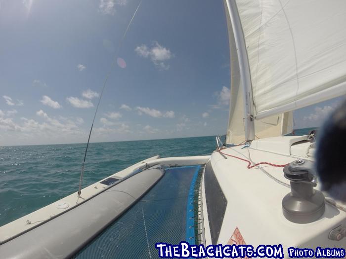

  • revintageMN3,
    Wonder under what load this sturdy rope is down to 5mm icon_wink .
    this much - thats dux on a 45' rotating mast (all colligo lines and fittings)
    https://www.thebeachcats.com/gallery2/main.php?g2_view=core.DownloadItem&g2_itemId=130090&g2_serialNumber=4
    Actually Mike K knows. He has a pull machine to test these kind of things - he knows real numbers
    Edited by MN3 on Jun 27, 2018 - 07:49 PM.
