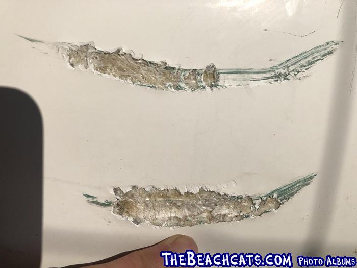

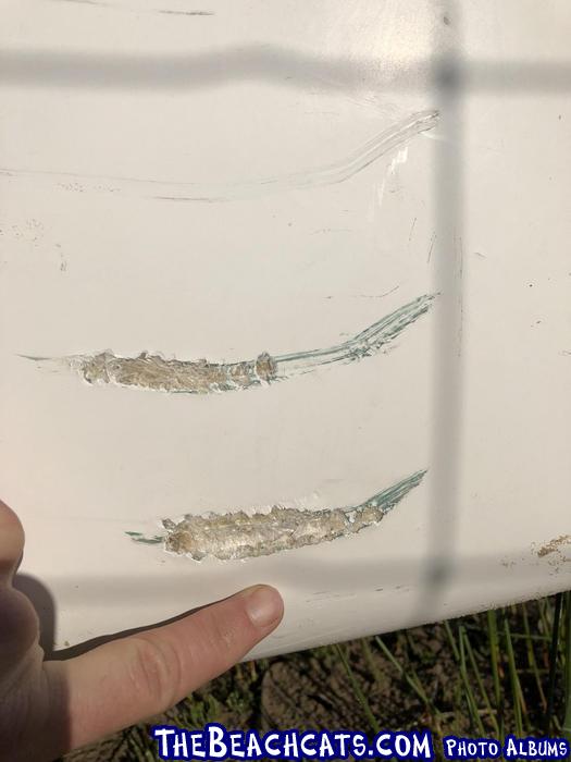

Appreciate all of the help. Here are a couple of photos. Two questions:
(1) I would love to sail a couple of times before hauling it off the beach to repair. That foolish? Am I going to cause further damage if I immerse it? Expect it will leak a ton, or does the foam dramatically slow the ingress of water?
(2) Any changed opinions on easiest best repair approach given the pics?

Meh that’s nothing. Worst thing would be for water to start getting into the foam core and spread and cause delam in other areas. If you want to sail it just drizzle some resin into the area to seal it up. That doesn’t really look bad at all. A complete repair you’d need to grind down a bigger area so you can lay a few layers of cloth on it and regelcoat.
My nacra had a 2” cut in front of the front beam in the worst spot and the previous owner had been sailing it for years with just a piece of tape keeping the water out lol. -

You could do a quickie repair to get you through a couple days (or probably the whole season). It’s really not that bad. I would get some 80 grit paper, knock off any loose material and rough up the surrounding area. Give the area a wipe with acetone. Then cut one or two patches using 1/2 oz fiberglass mat. Mix up a couple ounces of polyester resin and put the patches on. If you mix the resin “hot” it will kick in a few minutes and be sandable within an hour. Give it a rough sand with the 80 grit and you’re good to go. You could do this down at the beach (you certainly would not be the first cat sailor to fix a hull on the beach). Just be careful to keep sand out of the repair.

Guys thats barely into the glass, looks like gelcoat only to me. I'd fair/fill with a little bondo and hit with some gelcoat and go on my merry way. Of course if its deeper a little glass patch isn't a bad idea. -

I agree, wet it out with epoxy for good adhesion and penetration, and then fill with thickened epoxy. Fair until you find it acceptable. Then, the easiest finish is to spray with Rustoleum or Krylon epoxy spray paint for appliances. Color is either Biscuit or White. Done. You do need to cover the epoxy resin and filler with the paint or gelcoat, or the sun will break it down.
