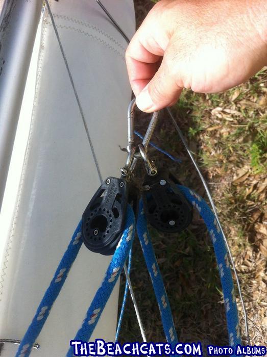

    I leave my jib sheets connected to the blocks and make a simple pigtail that i attach (via a knot and loop/soft-shackle) to the jib clew once it is raised (can be done with a shackle/ carabiner (img below) ... it really is simple and easy, even w 2 hands. Can be done without help unless it's honking wind, and then it is nice to have someone hold the clew to avoid it flopping around
    The only issue here is if you forget to put the jib sheets/blocks infront of the mast ball before you step the mast - if you use a pig tail, then you will have to undo one side of your jib sheet to get it infront. I simply leave the sheet infront at all times (during transit/storage) and it's almost never an issue.

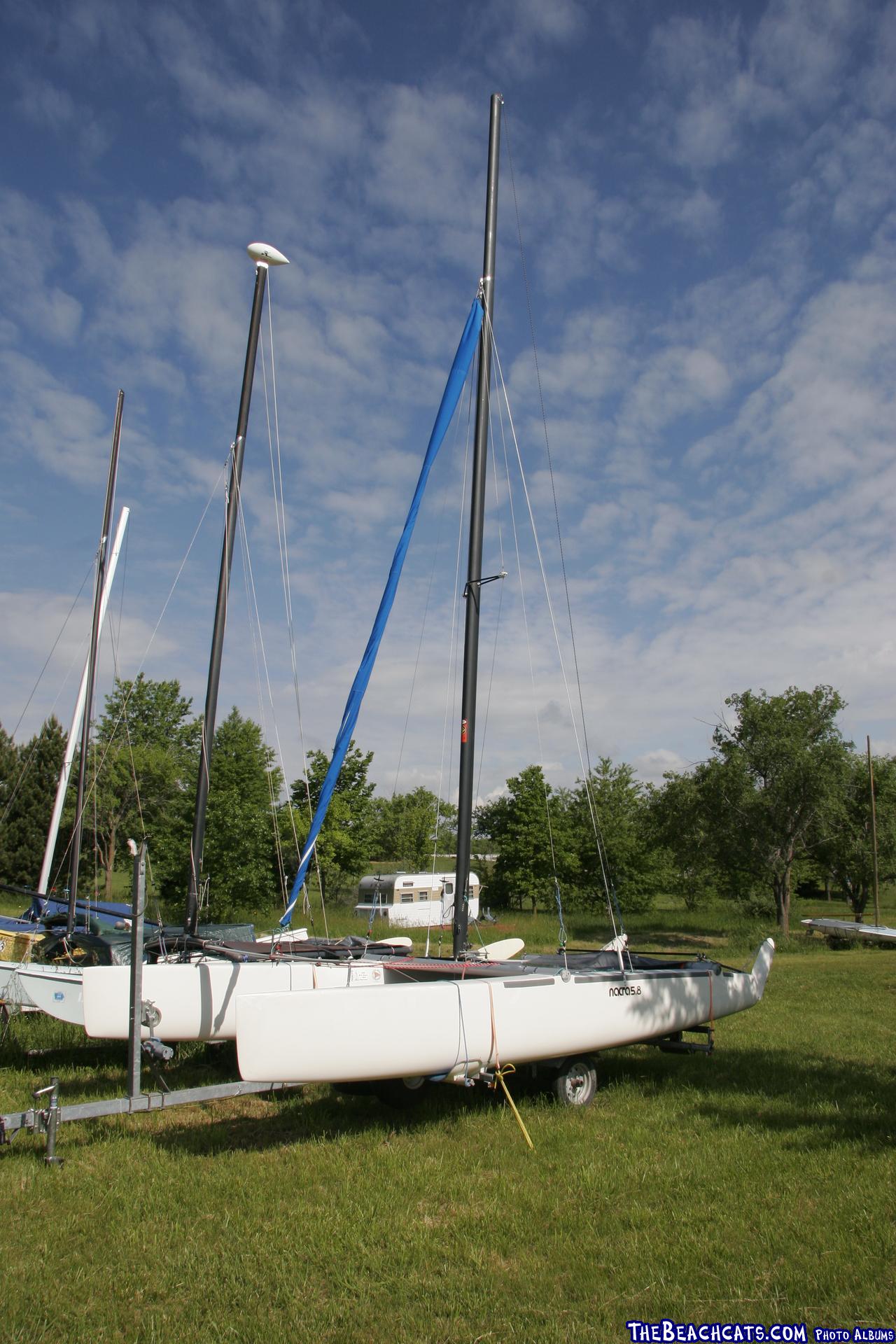

  • I had a furling jib on my Nacra which I left up all summer. the first jibsock was made by a local tent/awning maker but for my second one, i bought one they were marketing on ebay. i agree, the cost of parts and the hassle of making it yourself just doesn't make sense. bite the bullet and spend your time on the water.
