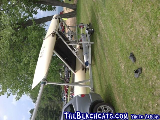

I towed my 20x10 Mystere on a custom tilt trailer. Other than lower fuel economy, and reduced acceleration, it was easy to forget it was behind you. It tracked without a wobble or bounce.

Nice trailer Edchris77. I notice you don't have the trampoline on. That has been my limited tilt trailer experience-need to take the trampoline off or you have a giant billboard, and in both cases need to load up the bottom of the trailer with concrete to get the C.G back down to normal.
If you are going to take the trampoline off, might as well undo 8 bolts and rack the boat up. Its easier to trailer and an arguably smaller footprint. -

It was off for the photo where the rig is attached to my van. The main needed replacement,(shipped from the manufacturer in 3 days, $525 USD), & i wasn't sure about a 500km trip on an Interstate style highway, so they were removed.
Some of the other photos showed the previous owner trailering with both main & front tramp installed. He towed using just a mid-sized Subaru car, without issue, though his route was fairly heavily treed.
That trailer has a pretty wide track, but if I were in Southern Alberta, during a strong Chinook wind, I think I would hesitate.
The C of G is OK, that fibreglass sail box & other gear weigh more than the hulls/beams, & the trailer itself is fairly heavy, even being aluminum.
I agree, if I had to remove the tramp each time, I would never buy one. The 10' beam makes it very difficult for a single person to install, as you can't reach to feed & pull.
With the electric winch, I could raise the mast & rig solo.
Edited by Edchris177 on Apr 06, 2018 - 05:22 PM.

I trailered my F20c on a tilt trailer and never removed the tramp. I put several thousand miles on it, sometimes with 30+ mph crosswinds and never had a problem. I fabricated my trailer using a pontoon trailer frame with the widest axle possible on it. I think between the wide axle and weight of the trailer it was very stable at highway speeds. -
