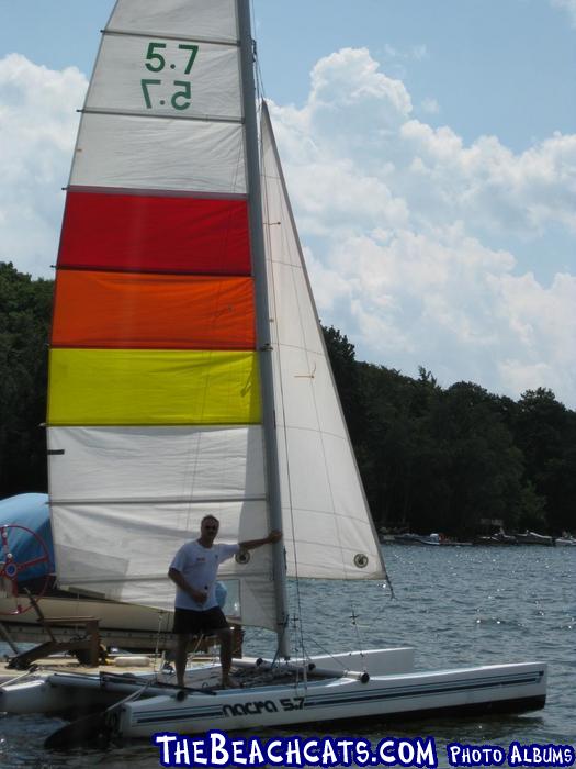

  • I have the original 1984 dacron Skip Elliott sail for my N-5.7. Still in service, but it tends to get very deep in the luff in higher winds. A simple sail with the original foam battens. This is from the past summer.
    https://i.imgur.com/Y8i4ixv.png
    https://i.imgur.com/sU0N5It.jpg
