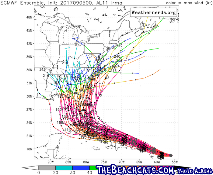

I saw that - seems to be at odds with some of the models which show landfall right around Tampa! I think we need a couple more days till we know we're OK. Regardless, we're preparing to stay, and preparing to leave: got a farm full of horses which we can't evacuate overnight so it's a major planning job! Hopefully we can just ride it out here though.

Some of the models have the storm going into the Florida panhandle and bringing it up into my neck of the woods up here in Alabama also, so we have been watching closely to see where this monster hurricane is going. I am far enough inland that the actual storm effects should be downgraded by the time it reaches us, but there is always the threat of tornados that spin off from these storms and that's what gets us. Back when Opal hit, our place on Lake Martin was badly damaged, and we had 5 huge oak trees fall hitting the house, smashing a carport, and breaking up concrete walkways, it was a real mess. Hoping and praying everyone is safe and get through this thing okay. It's coming for sure, all we can do is prepare and hope for the best.
