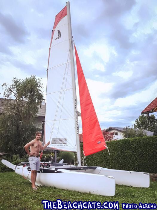

    i am just happy new owner of french catamaran 2win Twincat 15. I got it really cheap but it has some signs of use since it was used for renting as instructional cat. Good thing is that it is quiet new design (i think 2008) and it is still possible to get all the spare parts for it on the web.
    So as i mentioned, cat is not in the perfect shape, but with little love it could be totaly restored. What i wonder is about the mast, i noticed it is slightly bent above the wires, it also has 1" diameter dent there and one minor at the mast foot. We did test run before buying and everything went just fine but i wonder if that damage to the mast can present any risk.
    Thank you for advices.

  • The dent by itself is not a big deal in my opinion. And in the bend is gradual, that's ok too. But if it's a sharp bent at the dent I would be more concerned. If you can put some pictures up some of the more experienced guys can chime in.

    I doubt if the dents are a concern if they don't show any cracking, especially if you aren't running a spinnaker.

    You calmed me a little bit since the mast curve does not look to be really sharp, it is still in the area where cables are attached. I have not spotted any cracks there or stratch marks.
