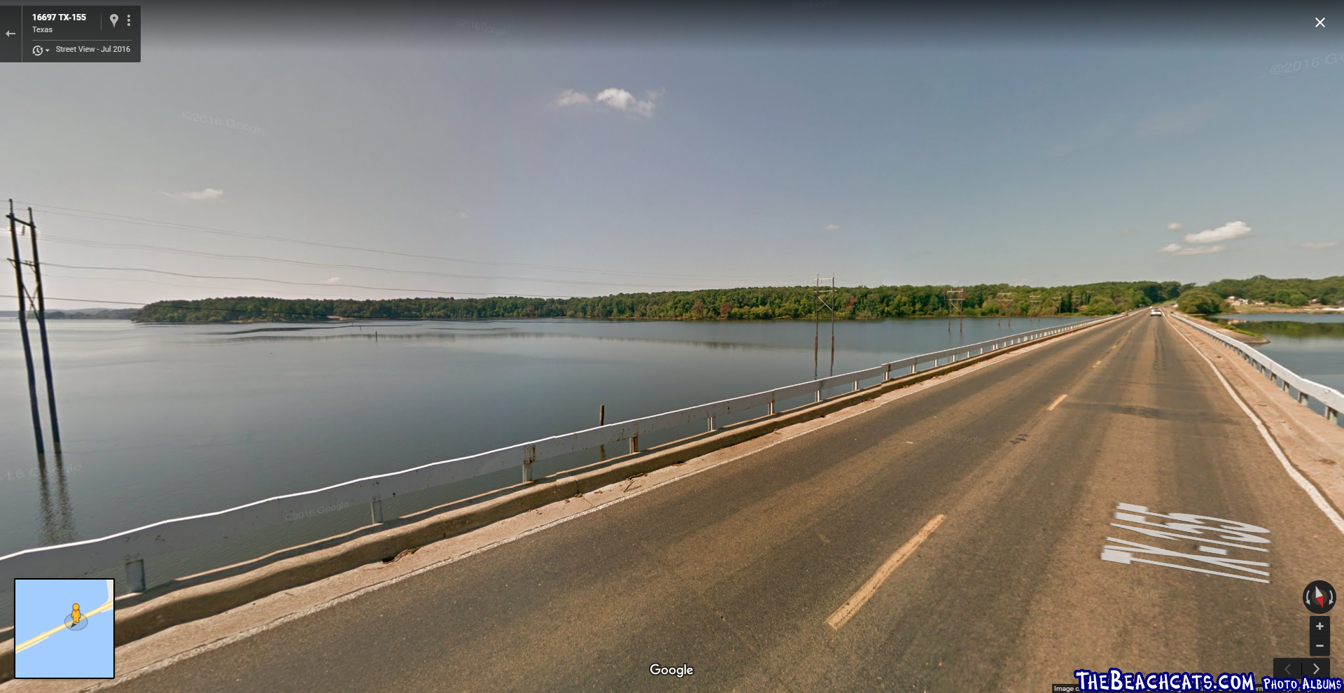

  • I was thinking it was unlikely there were power transmission lines over the water but there are.
    At the North end of the lake there is a bridge for TX highway 155 and just South of the bridge there are power lines.
    Reports did mention that the Scouts were having a weekend at a private residence located on the North end of the lake.
    https://www.thebeachcats.com/gallery2/main.php?g2_view=core.DownloadItem&g2_itemId=128578&g2_serialNumber=3
