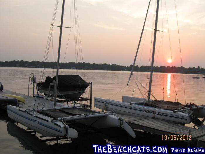

  • We keep an N5.0 & either an N5.7 or H18 Magnum, ( and had the 20' x 10' Mystere also) on cantilever SeaDoo lifts, the only thing s is that comes off each day is the mainsail. You will have to extend the "arms" of the lift to appx 7' 3". (you don't need the full 8', CTC of the skeg is 7')
    I recommend a furling jib setup, & leaving the jib up all season. With the Cat on a lift, even if the water is only 2' deep, you need really long arms to be able to stand in the water & reach the jib downhaul, or fittings to remove/attach the jib. You can lay a plank across the hulls, but that gets old real fast.
    The H18 has a downhaul cleat built into the jib, not so on my Nacras. I added a small Clamcleat, just above the furling drum. I can just grab the downhaul, pull & cleat. No tying knots way above your head.
    I also secure one of those small ratchet straps across the hulls, about where the jib blocks attach, & another line from the bottom of the V-brace bar to the lift,(the DS lines up with one X beams of the lift).
    This has kept both boats safe, even in very strong winds.
    The only downside is hoisting the sail. You can't pivot the boat, & so have to hoist/douse when the wind is not dead on. The older Nacra was very easy, even with the sail being pushed against the shrouds. The H18 can be a PITA. You may be able to tie a line from the dock to a bridal, & let the boat swing while you raise.
    Looks like this;
    https://www.thebeachcats.com/gallery2/main.php?g2_view=core.DownloadItem&g2_itemId=109397&g2_serialNumber=4&g2_GALLERYSID=c897009de4fbc0e863ebcc87258d0bc7
    https://www.thebeachcats.com/gallery2/main.php?g2_view=core.DownloadItem&g2_itemId=87703&g2_serialNumber=6

  • Nice setup @Edchris177
    I like the idea to keep the jib on. Agree that in the water, you cannot really reach the jib and all the workarounds will piss me off quickly.
    I do not understand all the details yet, but will look at it :)

    which inside opening version of cantilever lift you use? Looking at the red wheel I guess this is LSP lift.
  • QuoteLooking at the red wheel I guess this is LSP lift.
    Yes, that one is an LSP, From the instruction booklet- Model LSC964 900lb 64" Beam Jet Lift
    I drove across the Line & picked it up from a dealer near Canadaiuga Lk (SP?). I think it was only $400 at the time.
    You need to measure the width INSIDE your hulls, & make sure that is wider than the width OUTSIDE of the supports the winch mounts to. The Cat has to stradle those posts.
    It works perfect for the Nacras. The H18 is a tighter fit, due the lip in the Hobie hulls.
    I heated & bent a piece of milk jug into a "U" & taped it around the beam the winch is mounted on, so if the Hobie hull contacts the beam, it will slide upwards without marking.
    I never used the bunks for the SeaDoo. I mounted a 2" x 2" thick walled steel tube, 7'6" long across the lift, & attached a 5/4" x 6" wide PT deck board to the steel tube. That provides ample support for the skeg hull Nacra. For the Mysterer, or other more fragile hulls, I made some cradles out of green sewer pipe. A small chock mounted on on end of each board makes positioning the boat easy when you are solo.
    My shore is shallow enough that I removed the legs from the lift. The Cat can catch a lot of wind, & the lift footprint is small. To ensure stability, I push a 2' piece of re-bar through the leg holes, then drop a 50lb pig weight over the re-bar.
    This kept it upright in a 60mph blow.
    The 5.0 sits on a smaller lift, where the winch post go INSIDE the hulls. It is not nearly as stable due to the small footprint of the lift. If you get something like a Hobie Wave, Nacra 4.5, or other boat with a short beam, you will have to find an older, smaller lift. My Dart 15 is only 7', & won't fit the LSP lift, but it is light enough to push up on the lawn solo, then wheel it away with the beach dolly.
    Edited by Edchris177 on Jul 28, 2017 - 11:36 AM.
  • Thanks for the reply @Edchris177
    good info that their smaller cantilever foot print might not be big enough to resist wave and wind. I should be able to figure out something with all those information :)
