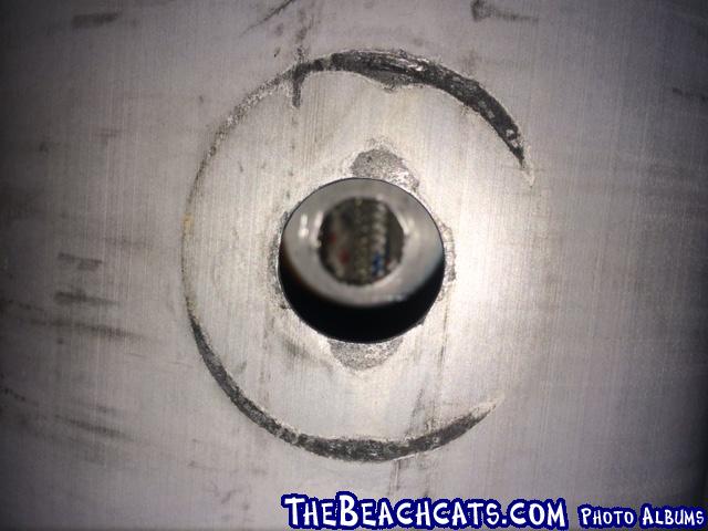

    I'm new to the forum and also new to my '83 Nacra 5.0. I was a little surprised to see the way the spreader passes right through the mast and I learned on here that there were originally some sort of rubber washers to provide sealing (sure). Today I set out to hopefully seal things up in a different way. Here's a picture before doing anything.

    I carefully cut a piece of 1" pvc to fit inside the mast at the hole. By "inside" I mean that the piece had to be slid into position by first removing the mast base. This was ok, since I was resealing it anyway. I chose 1" on purpose because the i.d. is about 1/4" bigger than the hole in the mast.
    https://www.thebeachcats.com/gallery2/main.php?g2_view=core.DownloadItem&g2_itemId=127885&g2_serialNumber=3
    Once I got everything in place, it was surprisingly easy to slather on a healthy bead of 5200 to the inside of the pipe where it meets the mast. The hole is actually big enough to get your finger in there and create a nice fillet.
    https://www.thebeachcats.com/gallery2/main.php?g2_view=core.DownloadItem&g2_itemId=127887&g2_serialNumber=3

  • My 1976 Nacra 5.2 has the round spreaders too. I do some minor silicone around the large washers to keep some water out, but the main thing is to make sure the very top end of the mast is sealed. Unless something goes horribly wrong Nacra's are not real inclined to go turtle. Because of the way the spreader is loaded from opposite sides it will always want to shift around and breakor stretch any seal. Then as a fall back I also have a small hole at the base of the mast that is covered with an aluminum tape. If the mast gains any water from condensation (this is the biggest problem), rain or a wicked bad crash I can pierce the hole in the tape and slowly drain the mast out.

    I agree that the spreader sliding back and forth will break any seal, but my approach removes this concern completely.
