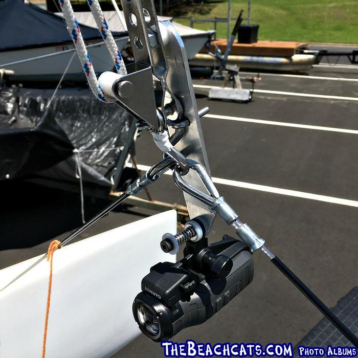

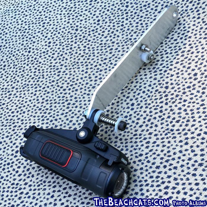

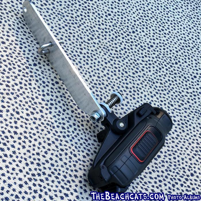

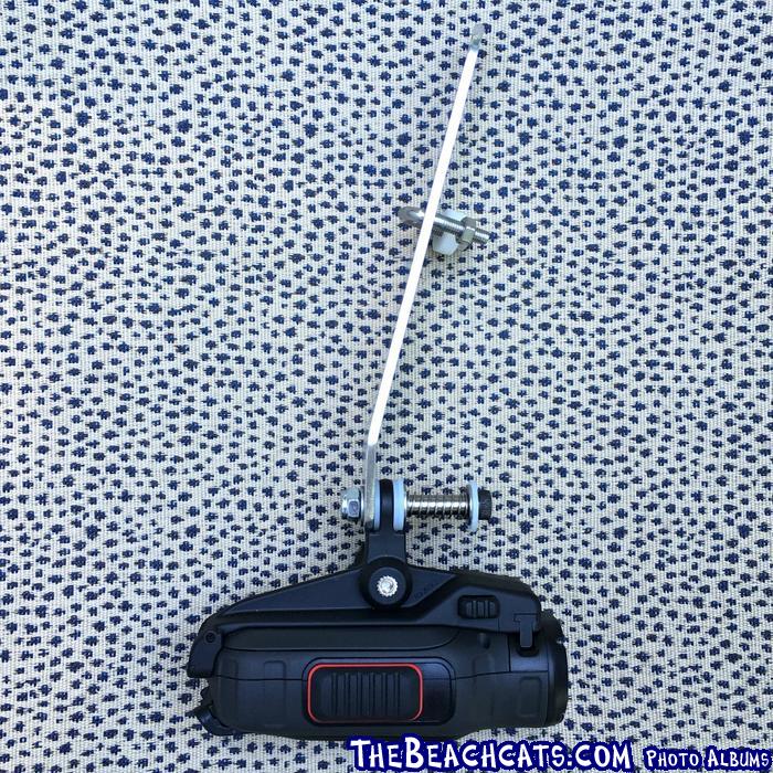

  • Pics as promised. Basically, 1-1/4" X 1/8" aluminum stock and a cable clamp from Home Depot:
    https://www.thebeachcats.com/gallery2/main.php?g2_view=core.DownloadItem&g2_itemId=127767&g2_serialNumber=4
    https://www.thebeachcats.com/gallery2/main.php?g2_view=core.DownloadItem&g2_itemId=127764&g2_serialNumber=4
    It's mounted to the forestay and bent near the bottom to bring the camera's position up to level. The gimble is just a shoulder bolt with a few nylon washers and a spring. At the top it's mounted with a 1/4" bolt through the bottom hole in the forestay adjuster. Note that this was a first attempt and needs some tweeking to improve shake and swing overshoot/return.

    Looks good and that's the simple principle just a free swinging pendulum. As you can see mine is damped with a spring so as to provide a constant force, but the way you have made it will work fine. The biggest challenge is how and where you mount it to the boat. In my case I get a lot of vibration that I didn't anticipate. Folks who use a pole from the dolphin striker up to the bridle Y get great low vibration results. I chose to not use the pole only because I didn't like it being in the center of the video's frame as a distraction.

  • andinista, are you saying that the go pro locking screws stay tight in this modification? They will not shake loose?
    I tried loosening the stock nuts/bolts to achieve pendulums on the X and Z axis. but they will back out when things started getting hairy. I tried rubber banding them in place but that's not the answer either.
    Using longer bolts with a locknut would be the way to go... have't got around to that yet.

  • nohuhuandinista, are you saying that the go pro locking screws stay tight in this modification? They will not shake loose?
    I suggest the use of Nylock nuts (Nylock is a brand name although there are other brands and some folks call them jam nuts). They are used extensively on aircraft and will prevent backing off and/or loosening plus you can reuse them many times (not on aircraft !@#$#@!).
