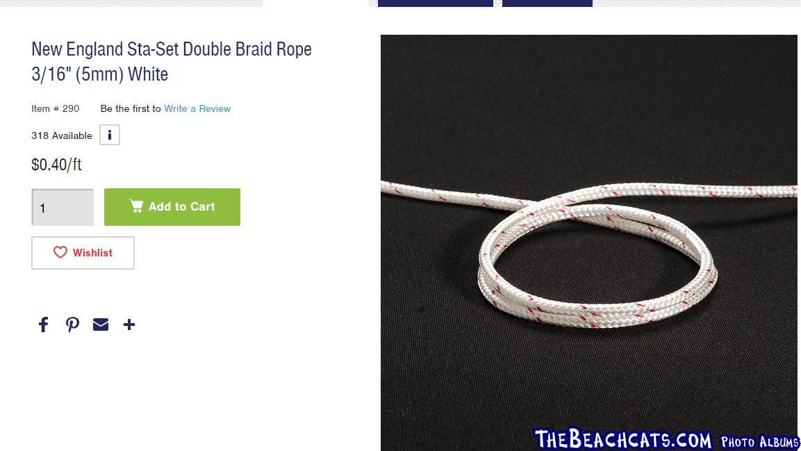

I am looking at New England Rope Sta-set on the Sailrite website. It is .45 cents a foot for the 3/16 size and I've narrowed it down to blue or red. This would be for the downhaul line and outhaul line so I would probably just go with one color for both. Looking at the line guide for line lengths, it states that the downhaul is like 5 feet and the outhaul is 7 feet 6 inches. This must be the lengths for a newer boat because my lines are nowhere near that long at all. When selecting a length of line on the Sailrite website, I am assuming that the little number between the plus and minus would be in feet? Is anyone familiar with that website? Seems very inexpensive and the shipping is reasonable as well.

When you select the line, there is a text field that you put in the amount of "units" (feet in this case) so you would order 20? (give or take)
PS for those 2 locations on your boat (not a sail control) I would get white with colored flex and save some $
PPS at that cost, i would order much more than needed - and cut as needed -

The white lines with fleck are the same $.45/ft.

Update. I ordered 15 ft of 3/16 Sta-set in red for the downhaul and outhaul lines. I will order more for the jib halyard and main halyard also. For the main halyard I will go with blue, for the jib halyard I will go with red. When I eventually change out the jib sheets and main sheets, I will coordinate those lines with matching colors as well. Jib sheets in red, mains in blue. I think this will look nice. My boat is, of course, yellow with nationals sails, and stripes on the hulls that have blue and red in them and the blue and red lines will go nicely with that. For starters though, I am just changing out the 3/16 lines and will address the bigger lines later. Thanks to all for the tips and advice.

I see now that the white line with very small red fleck is the cheaper one. Thanks.
