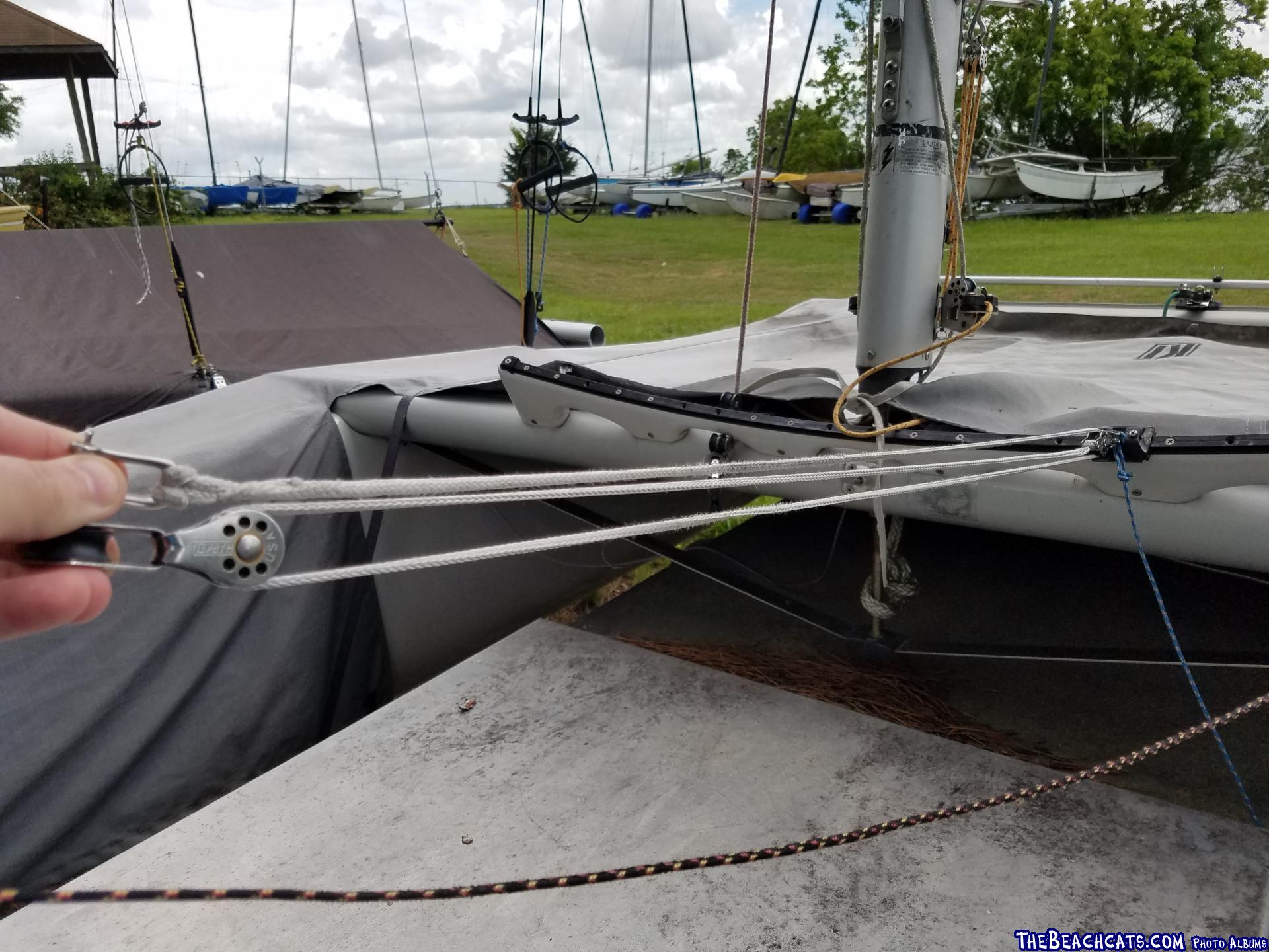

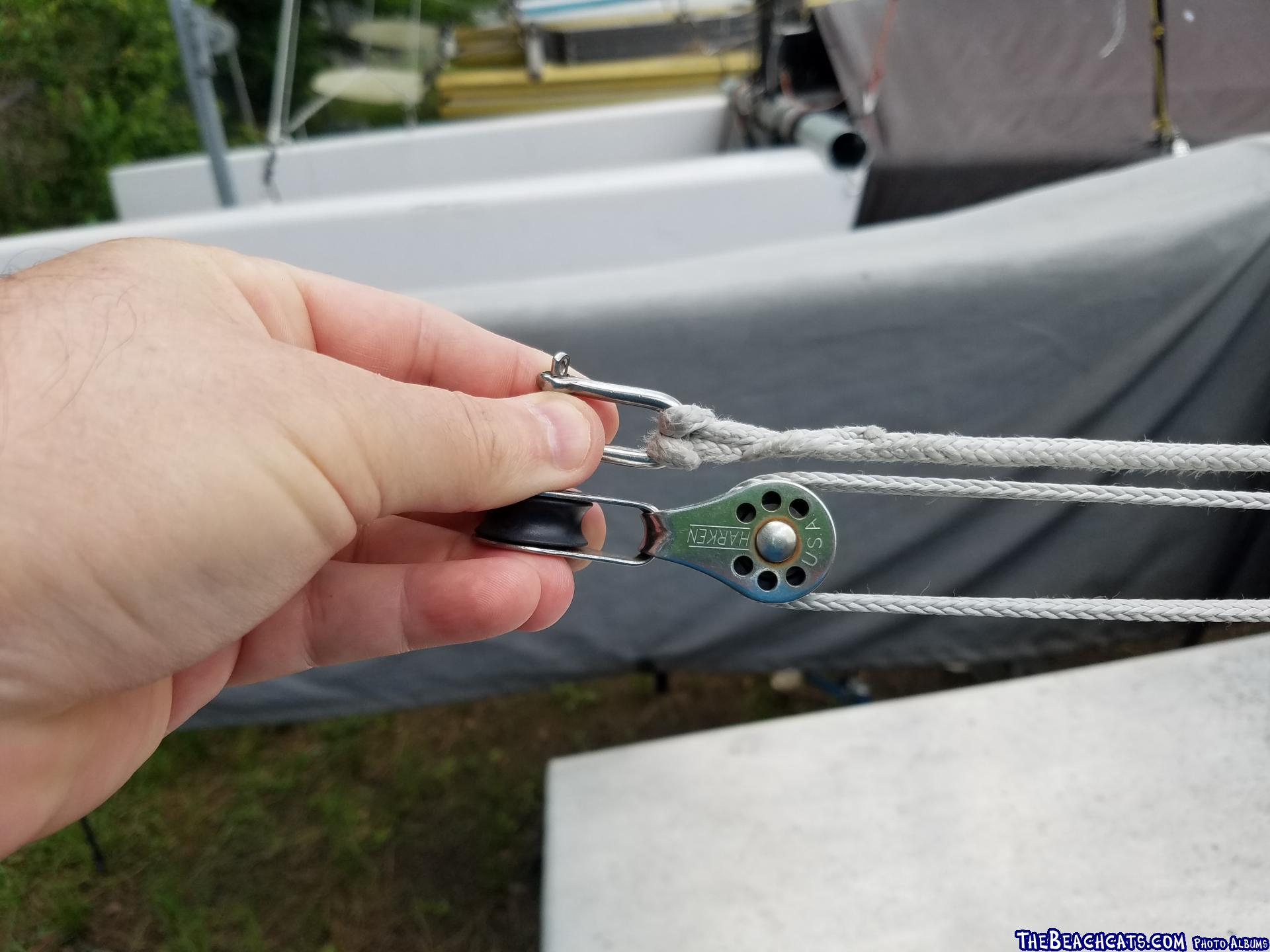

  • ericraylI played around after posting, and if I run a single line from the flying block (where you have the back-to-back) through the traveler block, and straight to the clew I have enough sheet to furl and can keep the 2:1 system advantage. That only works if the flying block is almost to the pair of blocks on the sprit when the jib is sheeted.
    We have a slightly different setup on our I20 where we went from a non-furling to a furling jib, so thought I'd share that:
    - We removed the flying block in pic 6 - this effectively makes our jib sheet one long continuous line from crew's hand to the jib clew (thus no furling limitations), but does take out one 2:1
    - We kept the existing block on the jib clew (so we still have 2:1 there)
    - Our jib track originally had a double block (instead of a single block with becket) so we use that to run both lines coming from the clew block to the bowsprit blocks, and from there back to the jib sheet cleats (note: one of our sheet cleats is missing, so we actually just use the port cleat and tie off the second end of the sheet on the starboard bowsprit block). Sounds like you don't have a double block currently, but could consider adding one.
    So I think we effectively went from 4:1 to 2:1 (similar to your new setup), but can now furl without limitations. We haven't noticed difficulty trimming with 2:1 yet (but have only had the boat 5 months). We're not that experienced with beach cats, so YMMV...
    View of our setup from the bowsprit:
    https://www.thebeachcats.com/gallery2/main.php?g2_view=core.DownloadItem&g2_itemId=127291&g2_serialNumber=3

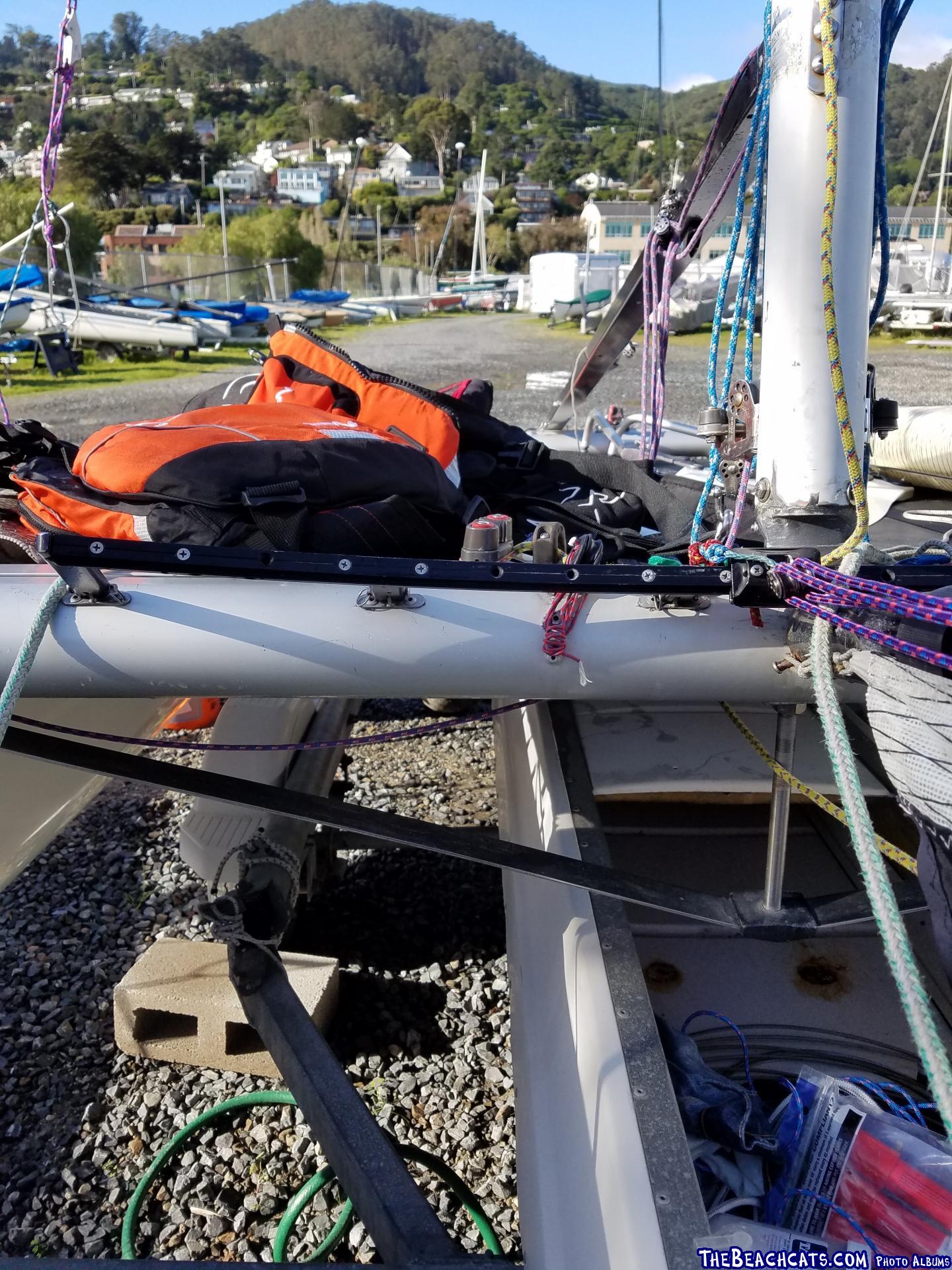

    View of our double block on the jib track:
    https://www.thebeachcats.com/gallery2/main.php?g2_view=core.DownloadItem&g2_itemId=127295&g2_serialNumber=3
