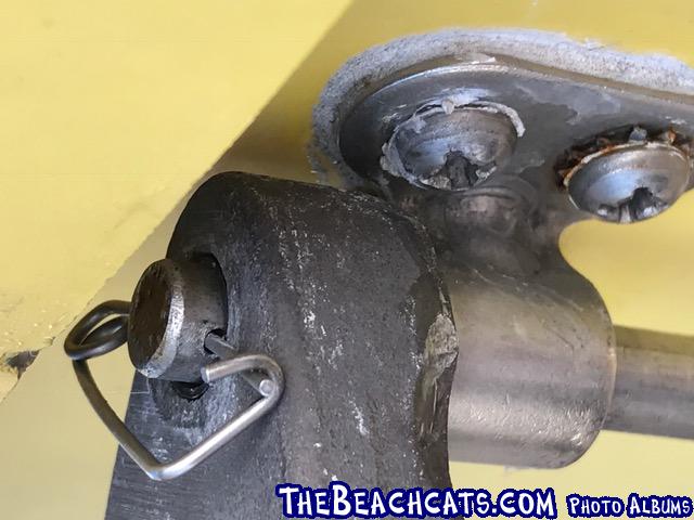

  • What are you using on the ends of your rudder pins?
    Could they be hitting the hull? Back in my 16 days, 20 years ago, I had some small stainless safety pins that I used as a quick pin. Got them from Murray's. They would rotate at speed and cause something similar.
  • nacra55What are you using on the ends of your rudder pins?
    Yea I have safety pins on the top. And I'm gonna guess that yes if they rotated just right they count get caught in the big hull lip an 18 has. I dont see why the rudder wouldnt still be able to rotate on the pin regardless on if the pin gets stopped from rotating though. Might be a good test to take out the pins and see if that fixes it. I have secondary holes lower down the pin that I just put line through anyway.
  • no doubt in my mind it is these safety pins your using
