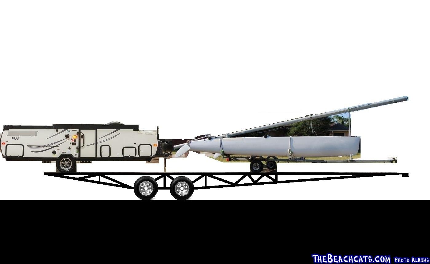

  • In traveling to many sailing venues it would be nice to conveniently and inexpensively have basic camping accommodations in tow. My first thought was hitch the camper to the back of the boat trailer (or vise versa) in a double articulated arrangement. Everyone I consulted said yes, possible, legal etc., but highly impractical and high risk for accidents not to mention backing up.
    My next thought was to build a flatbed large enough for both the boat and the camper thus returning to a single articulated arrangement which is familiar. I feel certain this has been done/attempted before. Anyone ever try it?

  • Seems pretty impractical to load two trailers onto another large trailer. i don't even know how you would do that. Winch them up? Then when you get to your destination, you have to unload them, hitch them to your car, and deal with three trailers? Don't think I would want to deal with that.

  • Like the drawing!!
    My concern/question is, is it road-legal with such length?
    Overhere in Europe the max length of a trailer is 12 Mtr (39,4 Ft)
    and the max length with towing vehicle combined is 18 Mtr (59,1 Ft).
    Looks you are a tat longer than that..

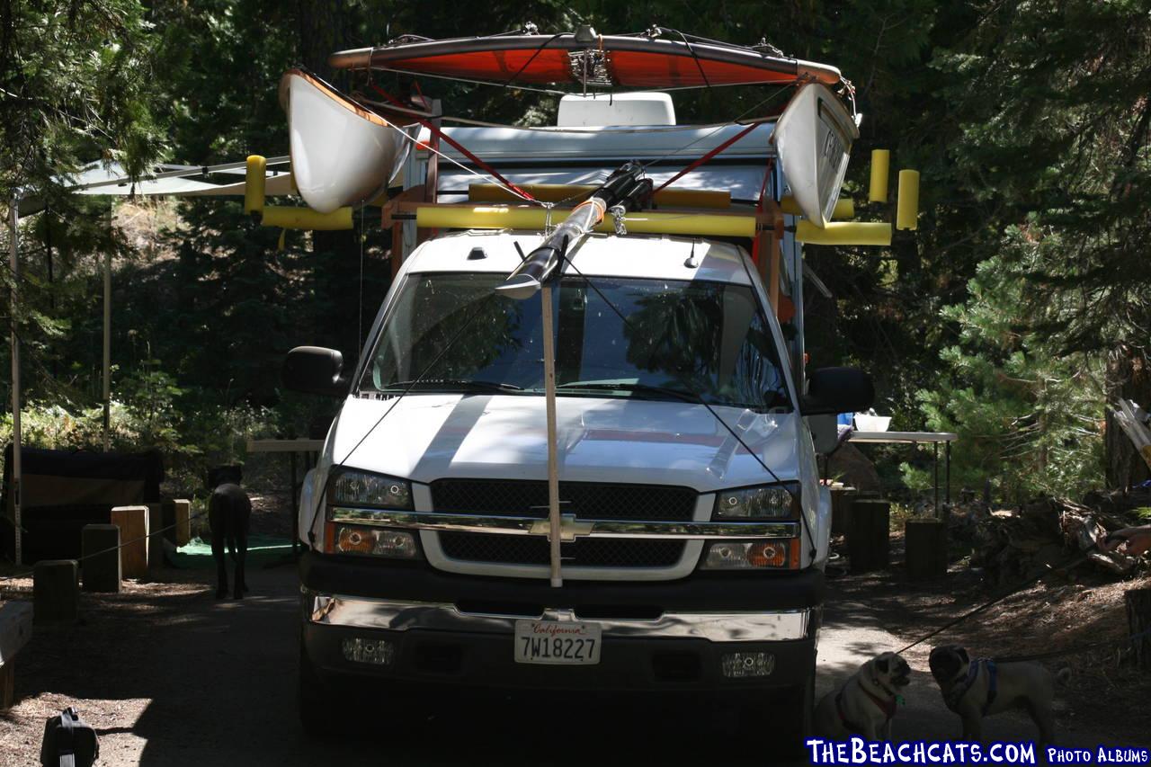

  • I think that you are overthinking this. I put a slide in camper in my pickup bed and tow the boat behind. I also
    have a stable lift which allows me to drive out from under the camper and use it without the truck leaving it for running around town if needed. Several that travel with me have motor homes that they tow their boats behind.
    Your plan to use a large trailer means having to own a truck so the slide in camper solves the trailer/camper issue.
    Also just noticed that you have a Hobie 16. I have seen people strap a 16 to the top of a popup camper.

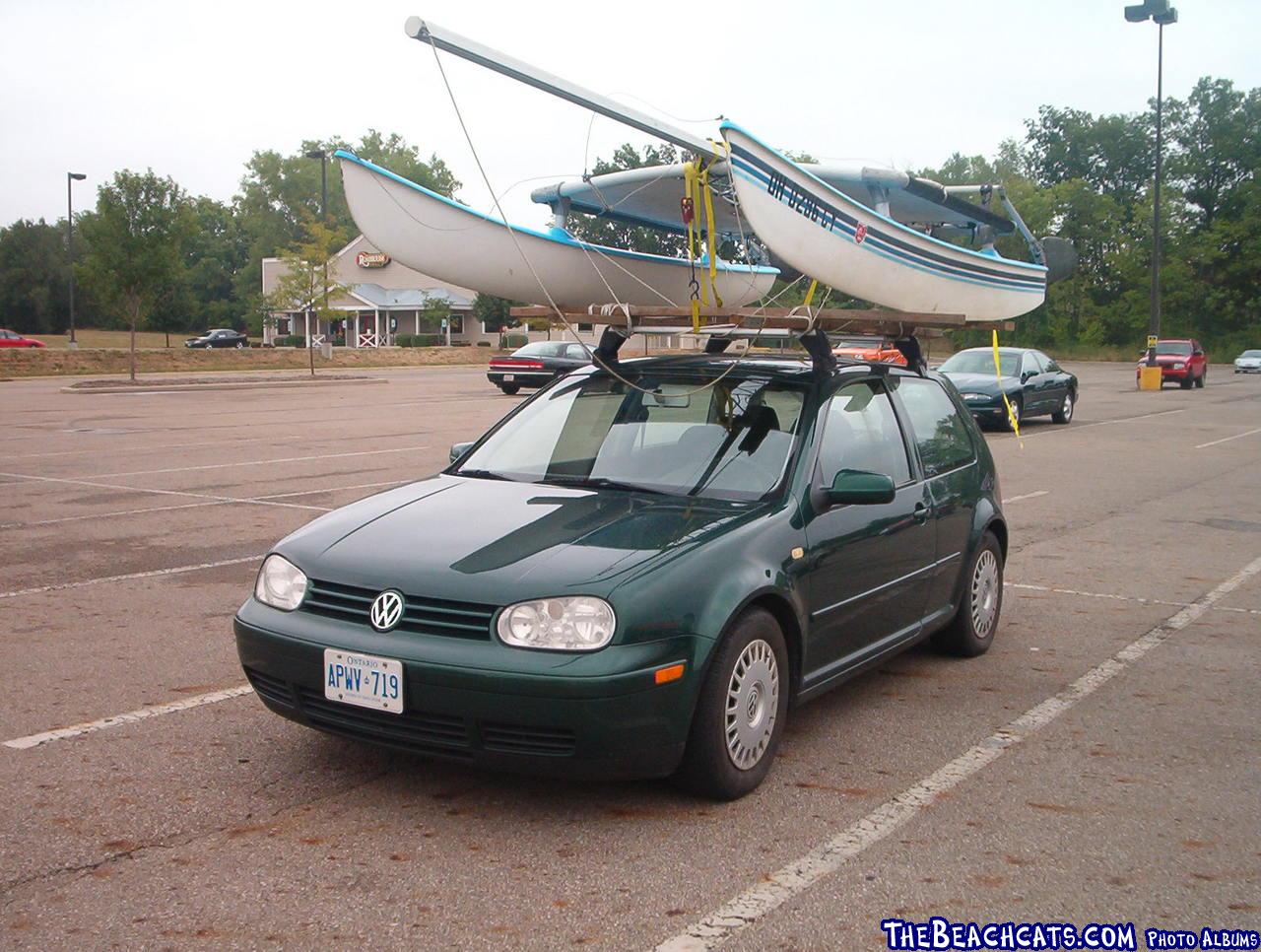

  • More practically, somewhere in the photo albums there is a picture of a PopUp camper that has had the crossbars from a Hobie trailer attached, then the boat is just lifted onto the roof of the camper, which is pretty low compared to those trucks.
  • DogboySeems pretty impractical to load two trailers onto another large trailer. i don't even know how you would do that. Winch them up?
    Ramps, a winch and a friend. Yes, a bit cumbersome, but... If you put the camper up front you wouldn't have to unload it, just pop the top and camp. You really wouldn't have to unload the boat trailer either, just lift the boat off as if it were on top of a camper. I was thinking of an Aliner hard sided pop up like this:

  • catmoddingLike the drawing!!
    Thanks. Just a quick paste up with MS paint to convey the concept.
    catmoddingMy concern/question is, is it road-legal with such length?
    In the US most restrictions on vehicle sizes and weights very be state. Generally you can go up to 40 ft. single articulated as long as you are under 10,000 lbs. without a special permit or license. Note that the 40 ft. is just the trailer, the overhang doesn't count.

  • Still not making a lot of sense to me. Loading trailers onto another trailer seems like a huge amount of extra work. Your boat is going to be about five feet up in the air. You're not going to be able to just roll it off. You will either have to unload the whole boat trailer and then unload the boat or lift the boat off of both trailers which will take at least four people. Not to mention all the added work of ramping/winching both trailers up onto the large trailer, getting them positioned and strapped down and then hauling around this monstrosity.
    Maybe consider getting a large flat bed trailer and mounting the pop up camper (sans frame, axle, wheels, etc) to the front of the flat bed and then mounting rollers/cradles in the back for your boat. Otherwise, a slide in pickup camper or a full on RV seem like a better route.
  • dogboyconsider getting a large flat bed trailer and mounting the pop up camper (sans frame, axle, wheels, etc) to the front of the flat bed and then mounting rollers/cradles in the back for your boat.
    Agreed.
    Lose the extra axles and reduce it all to one trailer.
    Once you setup and roll the cat off, that area could be your camper's front porch, or a cooking area, or armory- if you are a hunter.
  • You can buy a flat bed trailer with the front say 20' built out as an enclosed trailer, and the back half a flat bed. I wouldn't mess with bringing the boat trailer with you, just build supports for the boat on the flat bed.
