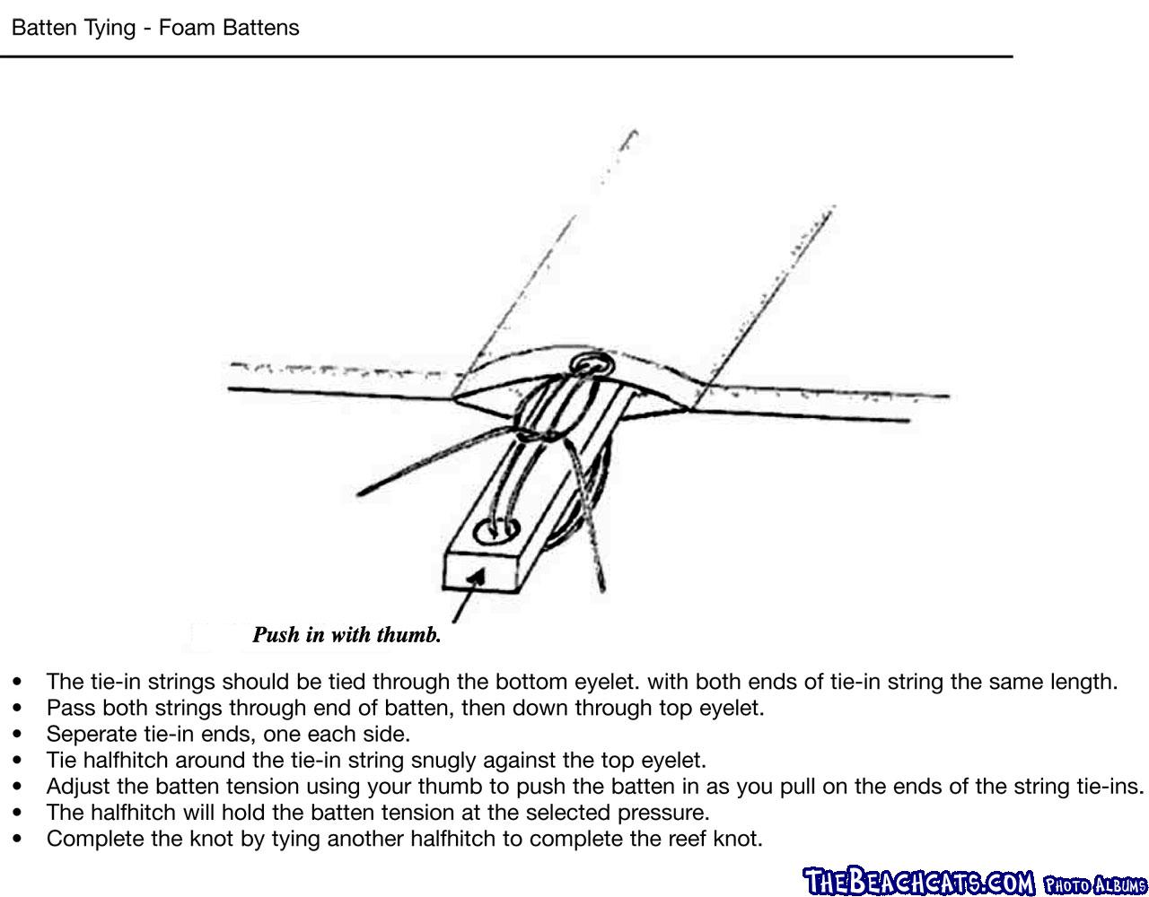

New sail to me with RBS battens. There are no leech end caps just two holes drilled in the portion of the batten sticking out (about 2") at the leech. I'm told you just thread it up (no idea what the threading pattern would be), tension as you wish and then tie a couple of half hitches? This sounds like a very cumbersome, time consuming way to tension and tie battens. I'm used to the Hobie (and/or TrenTech white) black plastic caps with a vee jam cleat which I find to be very easy to use. I have always tensioned my battens based on prevailing conditions each time I go out and then release the tension each time I stow my sails so as to not stretch the sail while being stored. Does anyone have a diagram/video of this setup?

I had to learn the technique when I got RBS battens too.
One thing I've tried to do on this site for years is collect these solutions .
Check out
http://www.thebeachcats.c…pictures?g2_itemId=67242
Which has a couple of different batten tying methods including the one I use, the nice thing about this is that the batten ties can be permanently tied to one grommet in your sail pocket so they aren't lost if you remove the batten.
