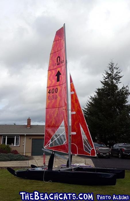

  • The weather today was nice enough to get the new sails up. The hulls are really dark blue, it is our lovely gray sky that makes them look so dark. But Tangerine comes through really well.
    http://www.thebeachcats.com/gallery2/main.php?g2_view=core.DownloadItem&g2_itemId=125973&g2_serialNumber=4
    Just a few more little details including the new vinyl lettering to go.
