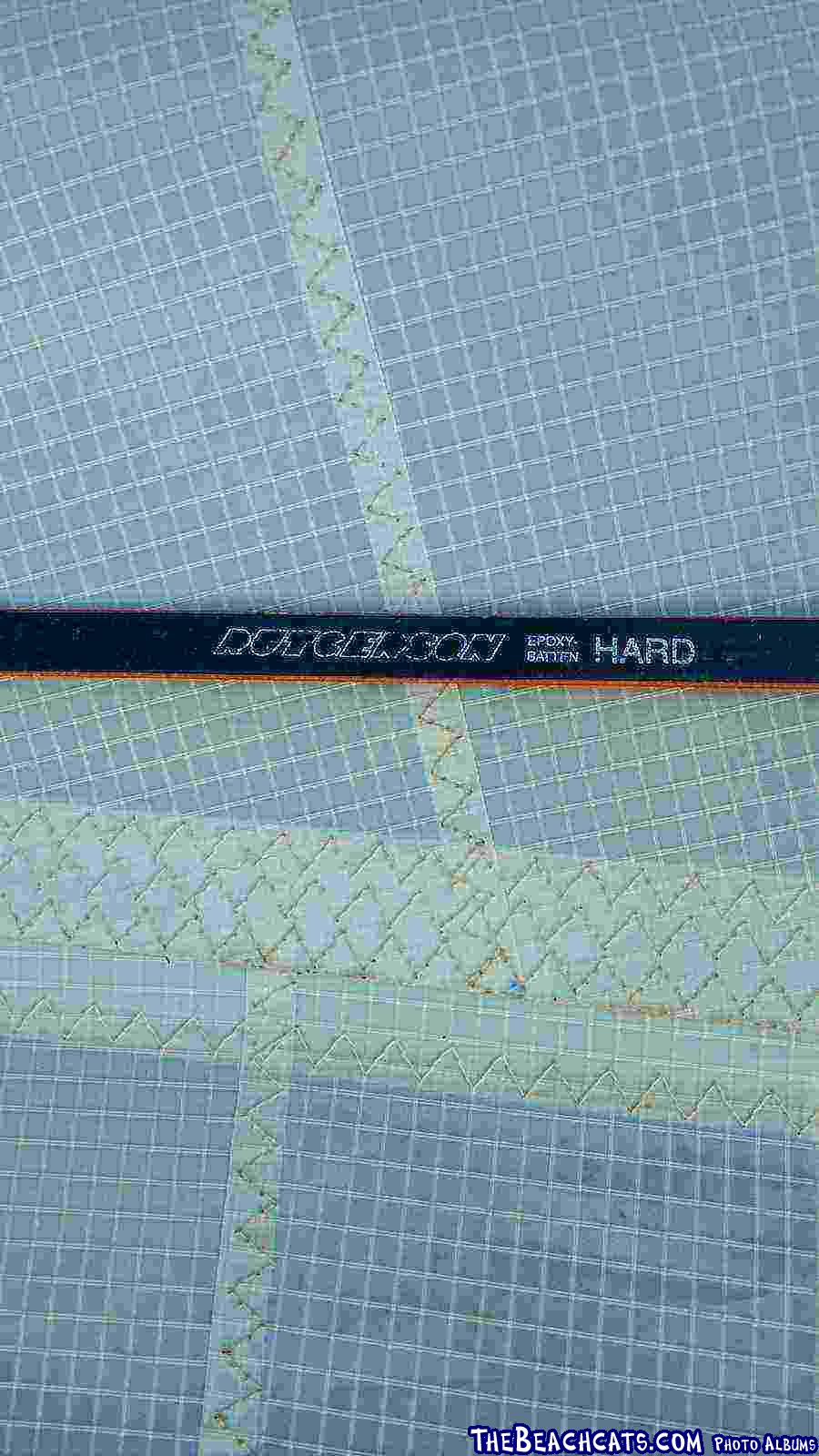

    It came with no battens, so I decided to put hard ones on it.
    Spent the afternoon setting them up.
    http://www.thebeachcats.com/gallery2/main.php?g2_view=core.DownloadItem&g2_itemId=125812&g2_serialNumber=5

  • If the picture of the batten is of the cloth that the main is made of, it's dacron, NOT mylar.
    I'd use the dacron main for light air days, it won't fair as well as a mylar or cuben main under load.

    Now I am confused.
    Yes, its the fibre of my new mainsail. The person
    I got it from told me its mylar...
    So, swop all the battens and go for the cuben main
    in the windy conditions I'm expecting?

  • It's not Dacron. But it's not Mylar either. It's a laminate with a scrim fiber in it. I have a jib made with the same stuff from ep sails.
  • Actually it may be Dacron with a pentex scrim..
  • From my seat, clearly looks like a woven cloth. Dacron, propbably a radial weave. The shape its built to is more important than the cloth IMO.

  • I had a jib for my 5.2 that was cut with a similar material to accompany my laminate main. "square" by DP. It's a woven dacron very crisp and racy. Here is the spec, yours could be this or similar but I don't think that it is Mylar.
    http://www.dimension-poly…m/en/pdf/DP_Square_E.pdf

  • That square weave is most likely a DP Dacron as mentioned above; funny enough, I just received a new light air Dacron jib (similar material, but lighter) for my T on Friday from Landenberger.
    Relative to mylar/pentax/cuben/etc. Dacron is quite a bit more "stretchy" and won't handle the kind of loads that one of the other sail cloths will. In the end, the Dacron sail will loose it shape more quickly than the other materials, especially if pushed harder/used in higher wind conditions. Not to mention, shape is more important in light/medium conditions, while being able to flatten the sail is more important in a blow.

  • Right,
    Went to the club and showed the main to the sailmaker.
    its definitely a dacron main, "new generation" are his
    words.
    Tested the main, not at the predicted strong winds.
    But 5-10 knts. And it is way to flat for those conditions,
    Downhaul almost lose (wrinkles out), foot tension loose .
    It was hard to lift a hull, and pointing high.
    So, despite the suggestions, gonna use it for the "harsh".
