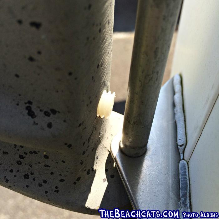

  • Do you have those little delrin screws in your rudder castings?
    Some of the castings don't have them, & some of the screws are deteriorated to the point they are not visible. They get VERY brittle. Easy o drill them out, cleanup the threads & replace them.
    I think I still have some threaded delrin rod. If you need them slightly longer thn the stock plugs, I can make them.

  • One side has a deteriorated Delrin screw and the other side does not. I have been unable to find a replacement, so thanks for your offer! The very light helm I experienced yesterday was on the side missing that spacer. Without the spacer, the rudders come further under the boat and increase the lee helm.

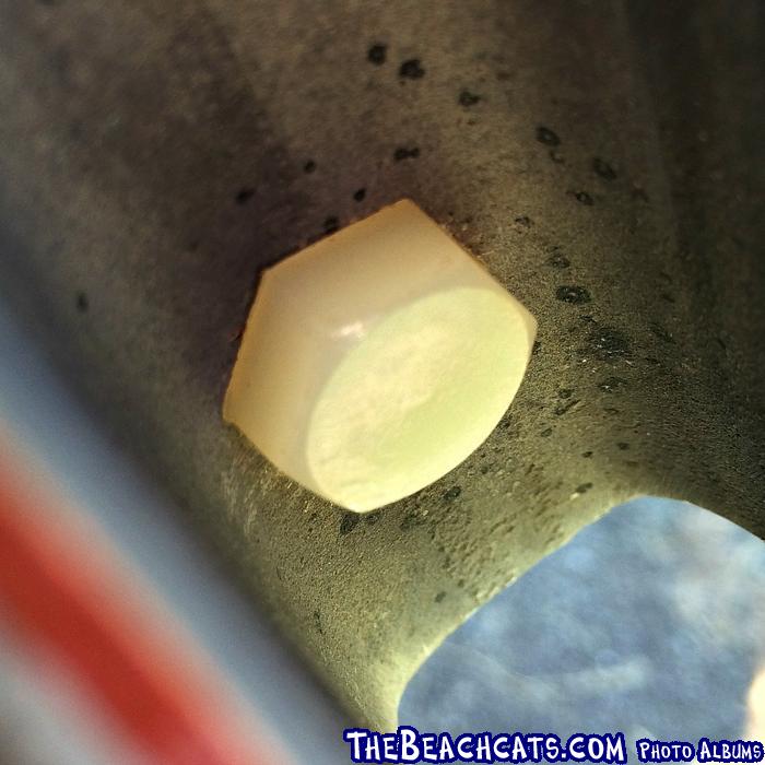

  • I buy these (3/8"-16 X 1" UNC Hex Head Nylon Bolt), cut the head off and hack saw a screw driver slot in the end then cut them to length. Note that Murrays specifies 13 threads per inch, but standard UNC is 16 and that is what fits my castings.
    http://www.ebay.com/itm/162036799258?_trksid=p2055119.m1438.l2649&ssPageName=STRK%3AMEBIDX%3AIT
    Right now I am using the actual bolt with the head left on cut to a 1/2" length screwed in from the inside. The rudder rests right on the bolt head which is about 1/4" thick.

    My boat is an '83 Nacra 5.0 which seems to balance for me "just right" (slight weather helm) with this amount of rudder rake and about 5 degrees of mast rake (5th hole up on the shroud adjuster for me).
    If you want more rudder rake (less weather helm), cut the head off and slot the end, then you have the magic Murrays $ 9 screw (nylon instead of Delrin, but they seem to work fine). You will likely need to use Blue Loctite with just the set screw as there is nothing for it to tighten up on to prevent movement.
    If you want less rudder rake (more weather helm), add washers under the bolt head one at the time until it feels perfect.

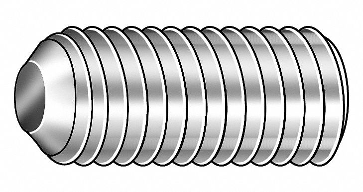

  • another option:
    i don't have any of mine handy but if leeboweffect is correct on the diameter and threads then do a search for 'nylon socket set screw' of that size and see what you get.
    i've bought and used those from grainger. not sure about the length but you can always cut them down if too long or order shorter ones.
    https://www.grainger.com/…fZ1z0o3p9%3FperPage%3D48
    https://static.grainger.com/rp/s/is/image/Grainger/1AV74_AS01?$lgthumb$
    nylon is soft so don't force them when screwing in or you'll mess up the screwdriver slot. ask me how i know..... icon_rolleyes
