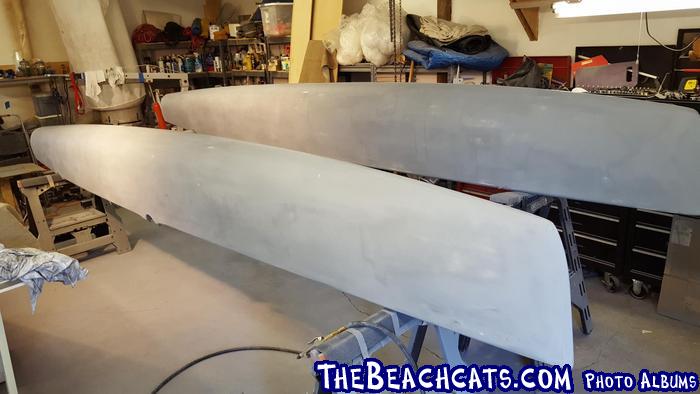

  • Here are a couple of images from today's adventures in the shop. The first shows the 5.2 hulls sanded to 220 grit ready for final.

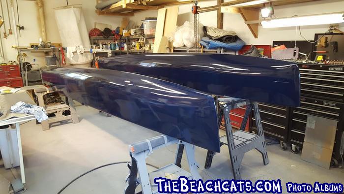

    The 2nd image shows the first coat of Mauritius Blue Perfection
    http://www.thebeachcats.com/gallery2/main.php?g2_view=core.DownloadItem&g2_itemId=124437&g2_serialNumber=4
    There is no doubt in my mind that perfecting this finish will be massively easier than what I did with the mast, beams and all the aluminum parts. But for sure there is a bunch of work to do. My plan is to put 3 coats on. I did get most of the bottom deck covered too and I am real sure that the new smooth decks are super cool.

  • The mirror gloss of that first coat sure is amazing. The camera captures that more dramatically in blue than in the arctic white I did. Are you mixing the whole quart peer coat, or measuring a smaller quantity?
  • I did the whole quart. Not that I wanted to. I would rather have mixed as I went along, but Interlux kind of sorted this out as mix as a quart. With the 20 minute wait they sort of forced the issue as to how much you mix up. There is a small area under the horses that didn't get covered, but most of the hulls did get one coat. I had some left over, but no where to go with it.
    Tomorrow, if my arms will still move I will wet sand out many of the imperfections. Then if my arms will still move I will sort out a 2nd coat. In the morning I will also sort out if I want to invert the hulls and work the other side of the equation.
    I get how this coating works, I am just not convinced yet that it is less work than spraying. For sure the hard finish will be seriously good looking when completed. I just hope that I don't get to meet a cardiologist in the process of making this boat look like I want.
