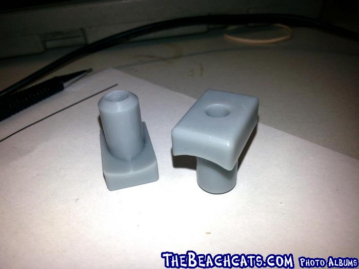

  • http://www.thebeachcats.com/gallery2/main.php?g2_view=core.DownloadItem&g2_itemId=125774&g2_serialNumber=3Thx Bob.. The kit was already on the Prindle that I bought but one spring was missing and they were not utilizing the extra spacers.. I'm using the same concept with the springs but adding my own 3D printed crossbar bushing instead of the extra Murray's spacers and swapping the bolts for stainless quick pins. Might have to go back to the 1/4-20 bolts with nyloc's but I take it apart every trip & don't want to wrench.
    Printing the crossbar bushings with a industrial resin.. I'll keep you posted
    Edited by carl2 on Oct 11, 2016 - 05:16 PM.
  • http://www.thebeachcats.com/gallery2/main.php?g2_view=core.DownloadItem&g2_itemId=125799&g2_serialNumber=4
    here is the printed bushings..more on the fit into the cross bar later icon_wink
    was going to use 6mm clevis pins but went back to the 1/4-20 hex bolt with the springs for tension (found the missing spring inside the tiller arm
    Edited by carl2 on Oct 14, 2016 - 02:47 PM.
  • carl2http://www.thebeachcats.com/gallery2/main.php?g2_view=core.DownloadItem&g2_itemId=125799&g2_serialNumber=4
    Looks like you have have some cool toys at your disposal! What material does your 3D printer use? Wondering about UV degradation.

    Your printed bushings are impressive.
    I'm wondering about UV also.
    Is there a Delrin source material available?

  • "Looks like you have have some cool toys at your disposal!"..Im in automotive design,whenever there is room in the tank I get to add stuff. icon_cool
    Im sure that there is UV degradation..the density is 1.19 g/cm cubed, very similar to nylon glass filled (pa66 density 1.18).
    mine will sit in the catbox till used and I'll replace them after a while anyway..could always paint them I suppose.
