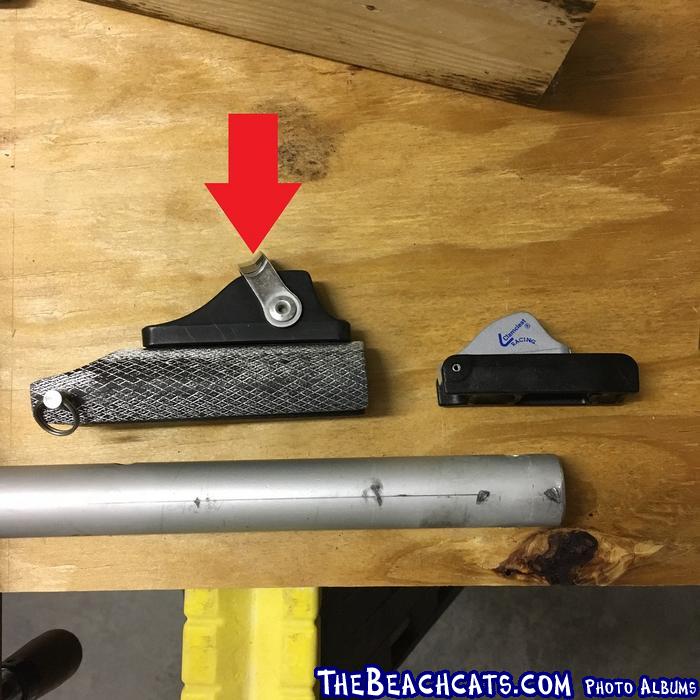

  • My N5.0 has the original Pivmatics which seem to do the job, but the break away force required seems a bit excessive. I have seen a few boats with the CL 257 and really like that the break away force is adjustable.
  • Update: I replaced the original pivmatics with the CL257 and they work well. However it is worth noting that the CL257 does not include a fairlead (line keeper) for the rudder pulldown line. Also, the pivot pin for the old pivmatic served as a stop for my rudder pullup shock cord. Solution: I took a couple of used fairleads (eyestraps) from some old swivel cleats and bent the legs to wrap around the tiller arm and reused the old pivmatic pin to secure the failead in the same location as the original pivmatic. I drilled new holes and mounted the CL257 a couple inches forward from this location.

    Thanks for the update. I'm just now being confronted with the same issue converting my Nacra 5.0. For me, the CL257 needs to be positioned relative to the old pivmatic hinge pin such that the shackle/strap placed there as a line keeper will engage my bowline and prevent line slack (rudder up position) and potential
    line jam. Film at 11.

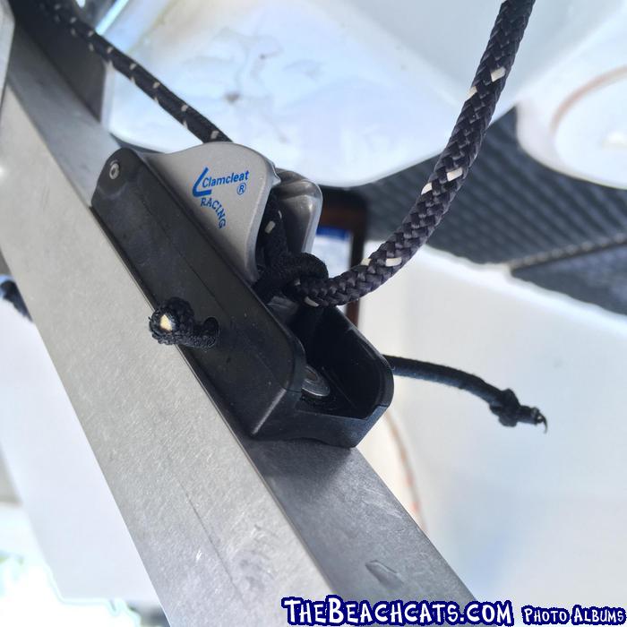

    I saw this setup on an Astus 16.5 trimaran. Someone drilled the CL257 and put a piece of 1/8" shock cord across the line as a keeper. I don't think that would work well for me, but might for other folks.

  • I run them and yea just drill some holes in the base or the cleat and run some line over the lock down rope to keep it within reach. Amazes me how a lot of people don't know about these. I talked to a bunch of A cat guys that had the standard cleat for rudder lock down complaining about how they get jammed if the rudder touches anything. I showed them what I was running and they ordered some right away.
