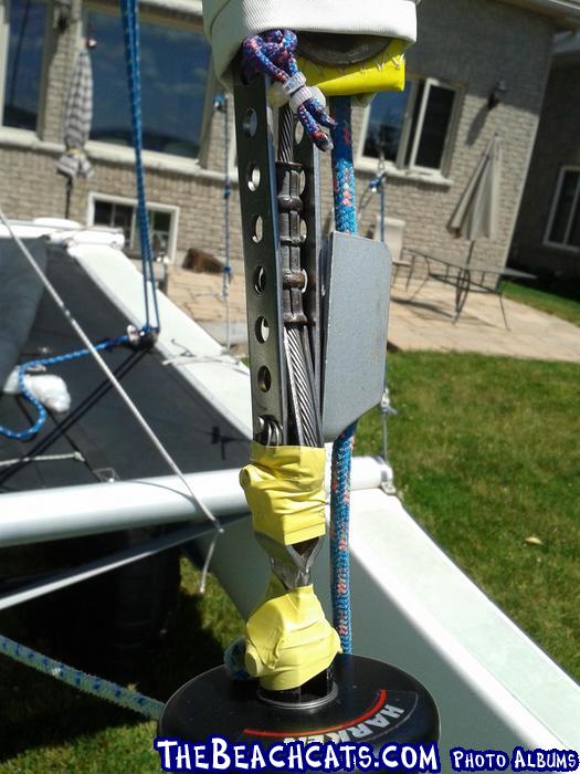

  • Here's sort of a picture of what I'm trying to describe.
    http://www.thebeachcats.c…pictures?g2_itemId=74384
    http://www.thebeachcats.c…pictures?g2_itemId=74387

  • As others have said, sheet in the main, then rig your jib. You have the same setup as mine, and I use small line with no problems. Looking at your first picture, run the halyard around the pulley on the cleat in the pic, back up around the block (the one that'll end up inside the zipper), then back down to the furler cleat. Pass the line through the back of the cleat (flat side), down through the ribbed cleat at the bottom, then back up to the eyelet at the top of the cleat. I tie off around the eyelet and around the 2 halyard lines running up into the jib using a couple of half hitches. There's virtually no pressure on the line, so it'll hold fine.
