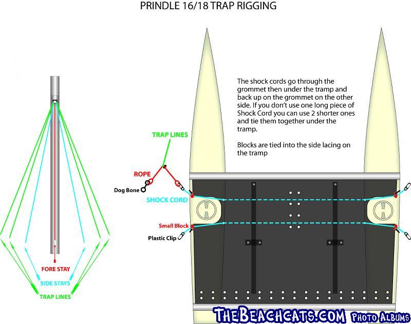

    One common issue is how to rig the trapeze, here is a diagram.
    http://www.thebeachcats.com/gallery2/main.php?g2_view=core.DownloadItem&g2_itemId=62071&g2_serialNumber=4
