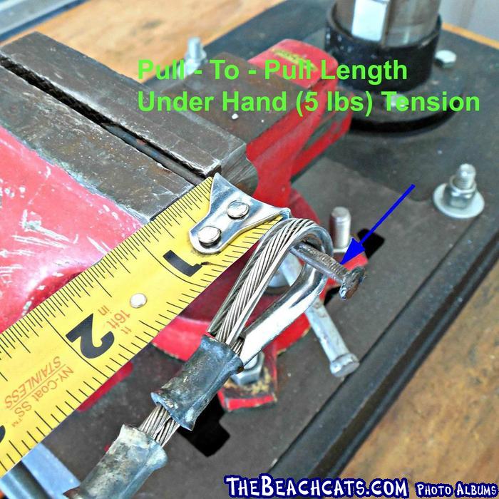

  • As one of my winter projects for the 5.0 I'm making up new standing rigging (1 X 19, 5/32" wire). I have the factory pull to pull lengths for the bridle wires and forestay, but need the length for the shrouds. Does anyone have it?
    http://www.thebeachcats.com/gallery2/main.php?g2_view=core.DownloadItem&g2_itemId=120170&g2_serialNumber=4
    Also, as shown above, much of the rigging I've seen around over the years has two nicropress sleeves at each thimble. Are two really necessary or is the second merely an unnecessary manifestation of OCD?
    Note that this will be my first attempt at making up rigging from scratch. Any advice would be greatly appreciated (particularly jig setups etc. to make certain the shrouds come out the same length).

    Measured my shrouds today:
    Shroud 1: 20' 5-5/8"
    Shroud 2: 20' 5-1/4"
