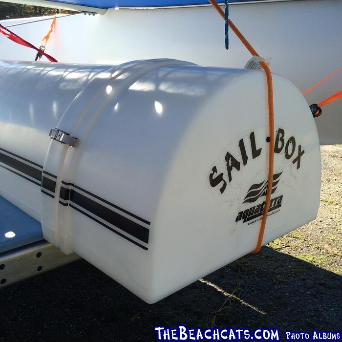

  • Came across an old Aquaterra Sail Tube recently.
    http://www.thebeachcats.com/gallery2/main.php?g2_view=core.DownloadItem&g2_itemId=120387&g2_serialNumber=4
    It appears to be in generally good shape, but to perform as intended, I must deal with a couple of known issues:

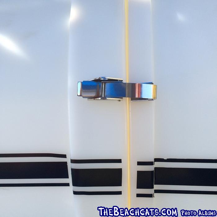

    The end cap latches are inadequate and don't securely hold the end cap on. Many end caps have been lost during trailering.
    http://www.thebeachcats.com/gallery2/main.php?g2_view=core.DownloadItem&g2_itemId=120390&g2_serialNumber=4
    This issue is relatively easy and cheap to deal with, simply purchase and install something more robust. Here is what I plan to use from Home Depot, Everbilt sku # 14569 in stainless, one per side:
