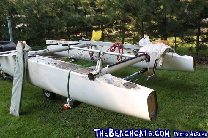

  • Just Picked up a Nacra 5.2 and here are some pictures. I have a bit of work ahead of me if I decide to get this back in the water.
    http://www.thebeachcats.com/gallery2/main.php?g2_view=core.DownloadItem&g2_itemId=119733&g2_serialNumber=4 http://www.thebeachcats.com/gallery2/main.php?g2_view=core.DownloadItem&g2_itemId=119737&g2_serialNumber=4 http://www.thebeachcats.com/gallery2/main.php?g2_view=core.DownloadItem&g2_itemId=119759&g2_serialNumber=3 http://www.thebeachcats.com/gallery2/main.php?g2_view=core.DownloadItem&g2_itemId=119743&g2_serialNumber=4 http://www.thebeachcats.com/gallery2/main.php?g2_view=core.DownloadItem&g2_itemId=119746&g2_serialNumber=4 http://www.thebeachcats.com/gallery2/main.php?g2_view=core.DownloadItem&g2_itemId=119749&g2_serialNumber=4

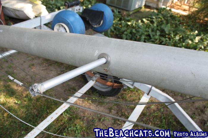

    Some of this I have never seen before. Old Nacra mast base ball, no pivmatic rudder system, crack in hull a few of the challenges.

  • The further I get into this boat the closer I am to calling it a parts boat and scrapping it. Found a major soft spot today under a small crack on the starboard hull just in front of the forward crossbar. I have scrapped Hobie 16s for much less damage but am not sure about the Nacra.

  • A soft spot on a 1976 5.2 is different than on a hobie 16. IT doesn't have a foam sandwich construction, so it wouldn't be delamination. If you do have an actual soft spot then it would be a structural issue with the fiberglass. i.e. the fiberglass in that location is busted up and cracked throughout. YOu would need to cut out the soft spot and reglass. Now keep in mind that the non foam sandwich nacra's tend to 'oil can' on the sides of the hulls and the decks. They arent too stiff. If you push on the hull and it pops in and out across the full hull without too much crackling then it might just be oil canning. If it really is a major soft spot where it got smashed then that is major surgery on the hull and probably isn't worth it for resale. You can get more for the parts.

    Thanks Wolfman, I will double check the hull tomorrow. I did not realize the older Nacras were that springy.

  • Good news, no crackling so the hull is repairable without to much work. I have not had a winter project boat for awhile but looks like this is gonna be it.
