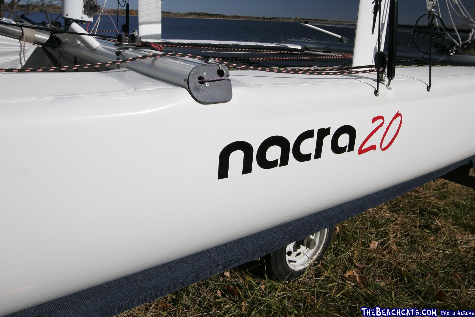

beard,
when you do eventually look into a logo, talk to a local sign shop. they can do just about anything.
i had these made for $30 each at SignPro. i modeled it after the original Nacra font and added a different font for the '20'. to each his own......do your own thing! j
