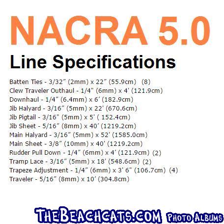

  • I am ready to start test rigging my 5.0. It came with no line so I have to procure a complete compliment. With the HIGH cost of new line an opps is to be avoided. Here is what I have found for the diameters/lengths:
    http://www.thebeachcats.com/gallery2/main.php?g2_view=core.DownloadItem&g2_itemId=119388&g2_serialNumber=3
    Can someone please verify this info.. With little experience on the boat, the only one that seems immediately suspect is the main halyard at 52' (that seems way long to me).
    Thanks In Advance
  • If it were me, all lines that are listed as 1/4 inch would be downsized to 3/16.
    The main halyard needs to be almost double the length of the mast. There is no wire on a Nacra main halyard like on a Hobie.

  • Also those line lengths are correct. The 5.0 and most pre 90 nacras do have a wire halyard.

  • QuoteThere is no wire on a Nacra main halyard like on a Hobie.
    Your Nacra uses a halyard that is part wire, part line, so you don't need the full 52' of line. I just replaced our '88 line last year, used 30'.
    Obviously, if you are getting a hundred feet or more, tie an end on, see how it fits, THEN CUT IT.
