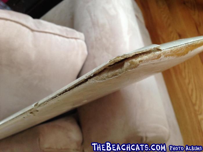

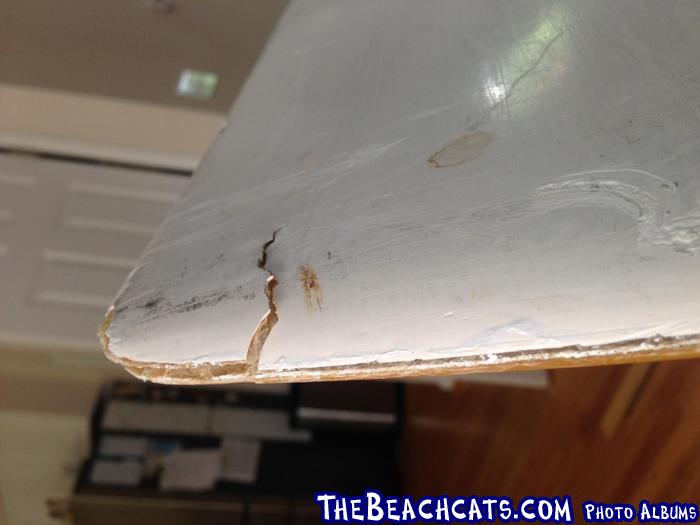

    now after many trials and tribulations i give you imagines:
    http://www.thebeachcats.com/gallery2/main.php?g2_view=core.DownloadItem&g2_itemId=119174&g2_serialNumber=4
    http://www.thebeachcats.com/gallery2/main.php?g2_view=core.DownloadItem&g2_itemId=119178&g2_serialNumber=4
    http://www.thebeachcats.com/gallery2/main.php?g2_view=core.DownloadItem&g2_itemId=119181&g2_serialNumber=4
    Maybe this will be of some help, the board is inside now (in the AC) and i'm hoping to do the repair this weekend if possible so i think that should give it plenty of time to dry out.
    I'm not worried about a pretty repair, but i do want a strong one and i only want to do it once.
    Thanks again for the advice!
    -Conrad
    1987 Nacra 5.8
    1978 Isotope (sold)
  • That is a real easy fix, & it wont look ugly. Mask off the surrounding area, it will cut clean up & sanding by 90%.
    Br gentle with prying it open, you want enough so the epoxy will flow completely down to solid material, but not enough to break off the gelcoat.
    If you are really anal, drip some UNTHICKENED,(or very little filler), epoxy into he crack, let it settle for 5-10 minutes while you add some microfibres to the rest of the batch. Pour out what will run out, then replace with a thicker mixture. This will leave no voids, & will be as strong as the original board.
    You will only need an ounce or two of resin
    The West system with slow hardener will give ample pot life.
    Your gelcoat looks pretty intact, the board will look as good as before, you will not need to do any further work, until you hit the next rock!
