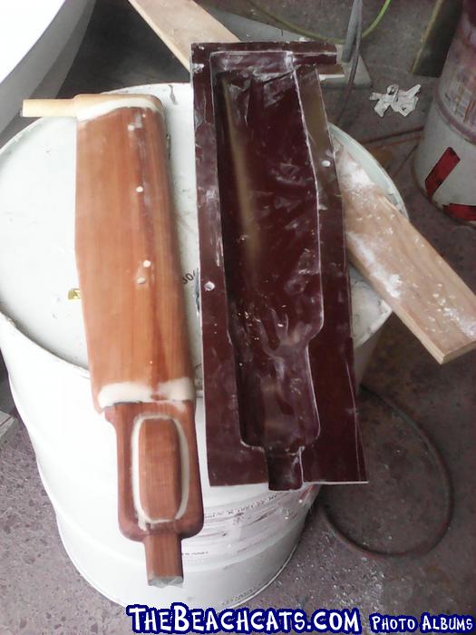

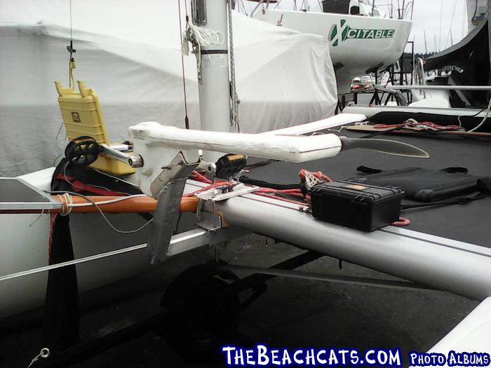

  • So a while back we where talking about the best boat for the race to alaska and then got started on human powering the thing. While with a week to go before the race starts the pedal drive my friend and I designed and built is done! Testing different size and pitch propellers atm but it will do 4.8kts with the big one, although its like pedaling up a hill!
    http://www.thebeachcats.com/gallery2/main.php?g2_view=core.DownloadItem&g2_itemId=118688&g2_serialNumber=4

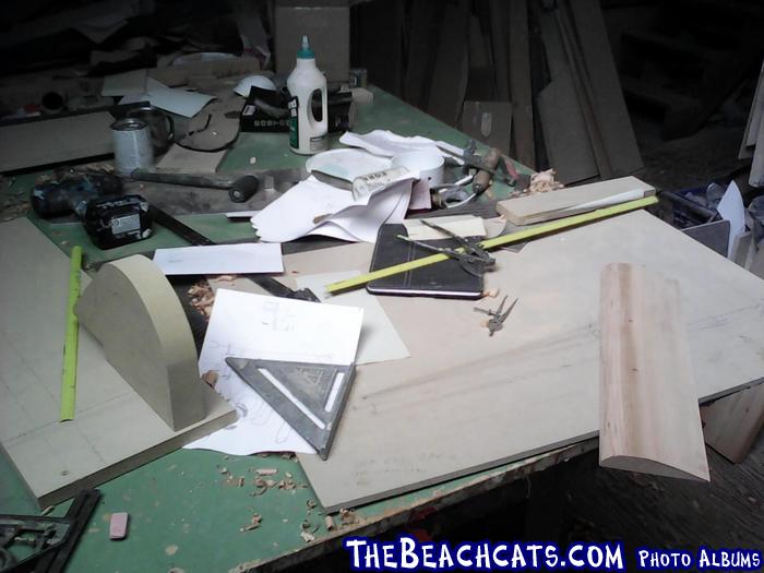

    It started with an idea and some blocks of wood.
    http://www.thebeachcats.com/gallery2/main.php?g2_view=core.DownloadItem&g2_itemId=118679&g2_serialNumber=4
    Finally got the plug together
    http://www.thebeachcats.com/gallery2/main.php?g2_view=core.DownloadItem&g2_itemId=118682&g2_serialNumber=4
    Made two female molds off the plug
    http://www.thebeachcats.com/gallery2/main.php?g2_view=core.DownloadItem&g2_itemId=118676&g2_serialNumber=4

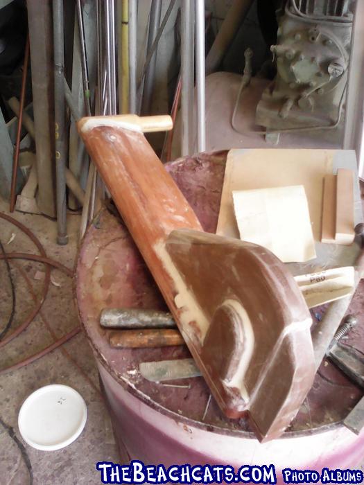

    Skip forward a few steps and we have the shell with some of the internals testing the mounting on the boat.
    http://www.thebeachcats.com/gallery2/main.php?g2_view=core.DownloadItem&g2_itemId=118669&g2_serialNumber=4
    Here it is all done (minus the top cover)
    http://www.thebeachcats.com/gallery2/main.php?g2_view=core.DownloadItem&g2_itemId=118673&g2_serialNumber=4

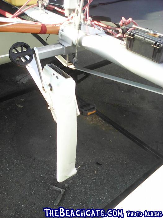

    In storage position

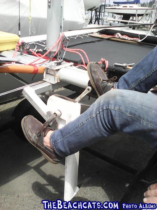

  • Interesting concept & design. My retired neighbor sails a Windrider, & it's surprising how quickly he can peddle if the wind dies.
    What are you using for a back brace when peddling?
    On a bike, your mass is directly over the crankshaft. Your cat looks like you will be constantly pushing your mass away from the crank. That is a very powerful position, if you have a back brace.
    I'm thinking it would be quickly tiring if you are just sitting on the hull. OK to peddle a mile, but maybe not if you are faced with hours.

  • QuoteWhat are you using for a back brace when peddling?
    Yep, this is key! My first concept didn't work to well, so I'm working on others. Needs to be light, removable, and not take up much space.

  • QuoteYep, this is key! My first concept didn't work to well, so I'm working on others. Needs to be light, removable, and not take up much space.
    Have you thought about a folding chair type arrangement that fits over the hull. Seat sits on hull, "legs" extend down inner/outer hull for stabilization, and a clamp from the side of the chair to the crossbeam (possibly connecting in the gap in the tramp at the corner) to keep it from sliding fore-aft?
    Your pedal drive is ingenious!
