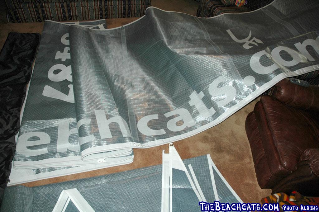

    Even a set of Pentex sails I bought from Whirlwind were shipped to me new flaked like this and it didn't seem to have damaged them, however I did prefer the way EP shipped, rolled in along box. You could do the same if just hate the idea of folding the sails, or if you are also shipping the battens. The key there is to make your own custom box and roll them as tight as possible. The box EP used for main and jib rolled up together (without battens) was only about 6x6 thick.
    Whirlwind
    http://www.thebeachcats.com/gallery2/main.php?g2_view=core.DownloadItem&g2_itemId=28726&g2_serialNumber=4
    EP Sails
    http://www.thebeachcats.com/gallery2/main.php?g2_view=core.DownloadItem&g2_itemId=107685&g2_serialNumber=3
