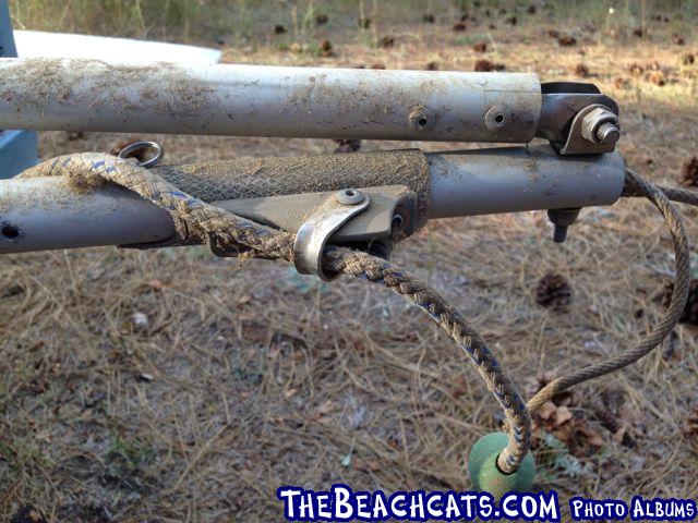

    QuoteUse low stretch line, this line is all that keeps the rudders tight in the "down" position. Make sure it is also line that holds well in a jam cleat,(if you have plastic jaws on your pivmatics, the teeth may be worn & all line will slip). The original pivmatics are no longer available, Murray"s sells a replacement part, or find the proper clam cleat & replace. You will want to remove the fairlead from the old pivmatic & rivet it to the clamcleat, keeps your pulldown line where you need it
    Are any lines you can buy from a sailing shop NOT low stretch? This seems redundant in the selection criteria between brands etc. My Pivmatic cleat is pictured below. It looks like plastic but I can't check right now. I don't really understand the Pivmatic - though once I play with it I'm sure I will. Does that pale colored fibre-reinforced 2/3 of a tube thingy pivot on its pin and snap away from the tiller tube if the rudder blade gets enough force pushing aft? (ie. hitting bottom). It looks very perished and brittle. I guess I'll just see if it lasts, and if it blows I'll replace it with the pull up cord system many seem to like.

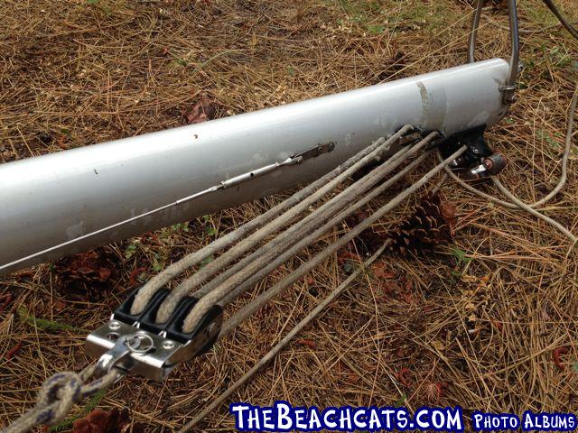

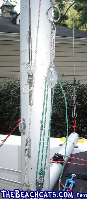

    QuoteAny decent fairly low stretch. I rig both Nacras like this, except at the top of the fiddle block (line with red/blue trace), I have an "S" hook. There is nothing to tie, just put the "S" into the sail grommet, pull to desired downhaul tension & yank line into V jam. 4:1 is all you need on those older sails, though you could make it 8:1 by dead ending that short line on one side of the mast, then running the line through the sail cringle, then attaching the bitter end to the top of fiddle block.
    My mast seems to be more modernized than the rest of the boat parts. I have a bunch of nice swivel cam cleats, and the S-hook you mentioned, and somebody saw a picture of my downhaul and suggested I had something crazy like a 12:1 system, which is really too much for this boat/sail. I'm open to suggestions to simplify it. Pics below. I can't say I understand the routing yet. And why is there two pivot cam cleats, one each side?

    Quote It looks like plastic
    I'm not sure from the photo. The aluminum ones were by Clamcleat & were silver. The plastic ones were black.
    Quote Does that pale colored fibre-reinforced 2/3 of a tube thingy pivot on its pin and snap away from the tiller tube if the rudder blade gets enough force pushing aft?
    Yes. When it pivots up & rearward, the line has to pop out of the cleat teeth, releasing rudder. They work, quite well.
    When the tube gets old, the little ears it pivot on get brittle & break off.
    Quote And why is there two pivot cam cleats, one each side?
    They have lead your downhaul to each side, so they can be adjusted from the wire, on either tack. Modern square tops try not to drop traveler, head up, or sheet out in a gust. It's faster to downhaul,(flatten sail) & maintain heading.

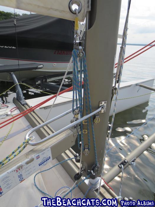

    Here is how my 20' Cat was rigged.(Click on photos for full size)
    http://www.thebeachcats.com/gallery2/main.php?g2_view=core.DownloadItem&g2_itemId=111924&g2_serialNumber=4
    Even if you have a new square top, your old mast is not designed to be a noodle. IMHO you are not gaining anything & might actually pull your sail apart.
    Do what I told you, 4:1,(or maybe 8;1 with the line loop), it's deadnuts simple. Sail it for a while, then decide it you benefit from some more complex setup.
    Edited by Edchris177 on Nov 24, 2014 - 09:01 PM.
  • Again I side with Chris on this one. The 12:1 downhaul is nice and you can rig it if you like but 5 or 6:1 will give you everything you need for that boat. I have a 10:1 downhaul on my 5.2 and a 5:1 on my 5.7 and honestly don't think its worth the hassle for the older boats. I end up just setting it and forgetting it. You can get the aluminum masts to bend pretty good without damaging them but not like the bendy masts on the more modern boats. YOu can set up your 12:1 downhaul but just be aware that you aren't trying to make your mast into a banana, just tighten your sail and remove the wrinkles.
