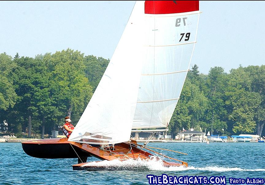

  • In case anyone isn't sure what a Shark Catamaran looks like, here is a picture of a Shark Catamaran.
    http://www.thebeachcats.com/gallery2/main.php?g2_view=core.DownloadItem&g2_itemId=25163&g2_serialNumber=4

    FYI- that is me and my wife in the Shark picture up above.
