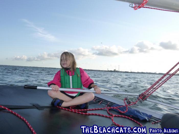

Damon - Here is a picture of my daughter at the tiller:
I also Googled around and could not find a single reference to this tiller extension, so it's strange I had 2 of them. I think a previous owner got them from Murray's. They look like Davis Marine's telescoping aluminum boat hooks but with a pivot plastic piece to attach it to the rudder cross bar, and the black handle is on the inner tube:
