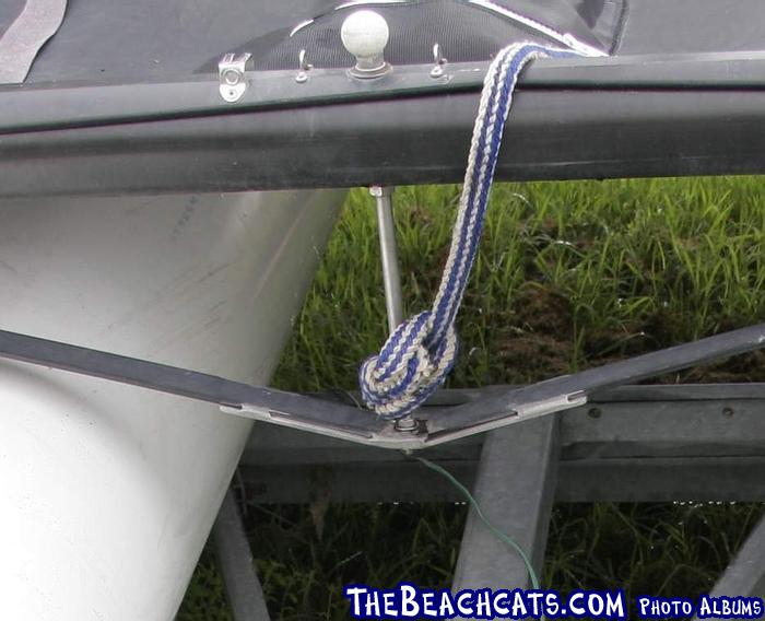

  • Don't know how much help may be out here, but I have a major problem with my old Trac16 cat. As I was preparing to trailer it out for a sail I noticed that my dolphin striker rod was no longer attached to the dolphin striker V-strap, there now being a gap of 1/4-1/2 inch between them. Notwithstanding that I have owned this boat since I purchased it new in 1986, I realized that I have no idea of what is now missing that connected the two parts. Just always took it for granted.
    I have been searching for other Tracs to look at and see how they are rigged. I found a 1984 model but it had a very different looking striker rod that appeared to be slightly longer and was simply attached via a bolt through the bottom of the V-strap and into the shaft of the rod. Mine is short enough that even if you could run a bolt through the rod (and I can't see that there are any internal threads anyhow), tightening the two together would cause the v-strap to bow upwards significantly.
    So it would seem as though there must have been some sort of fitting or base that sat upon the V-strap and the rod then rested on it.
    Does anyone out there have a Trac16 of 1986 or similar vintage that could describe to me how the rod and strap are connected? A photo would be priceless! And if someone knows of an owner of one that is parting it out that would be wonderful to know.

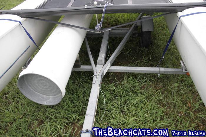

  • these are some photos of a friends trac 16 that has had a reinforcing repair on the dolphin striker. i'm not sure if the original part is still in there but it looks like it is. i'll ask him if he has any other photos before the repair and if so, i'll post them. not sure if this helps.
    http://www.thebeachcats.com/gallery2/main.php?g2_view=core.DownloadItem&g2_itemId=109451&g2_serialNumber=4
    http://www.thebeachcats.com/gallery2/main.php?g2_view=core.DownloadItem&g2_itemId=109448&g2_serialNumber=4
    j
