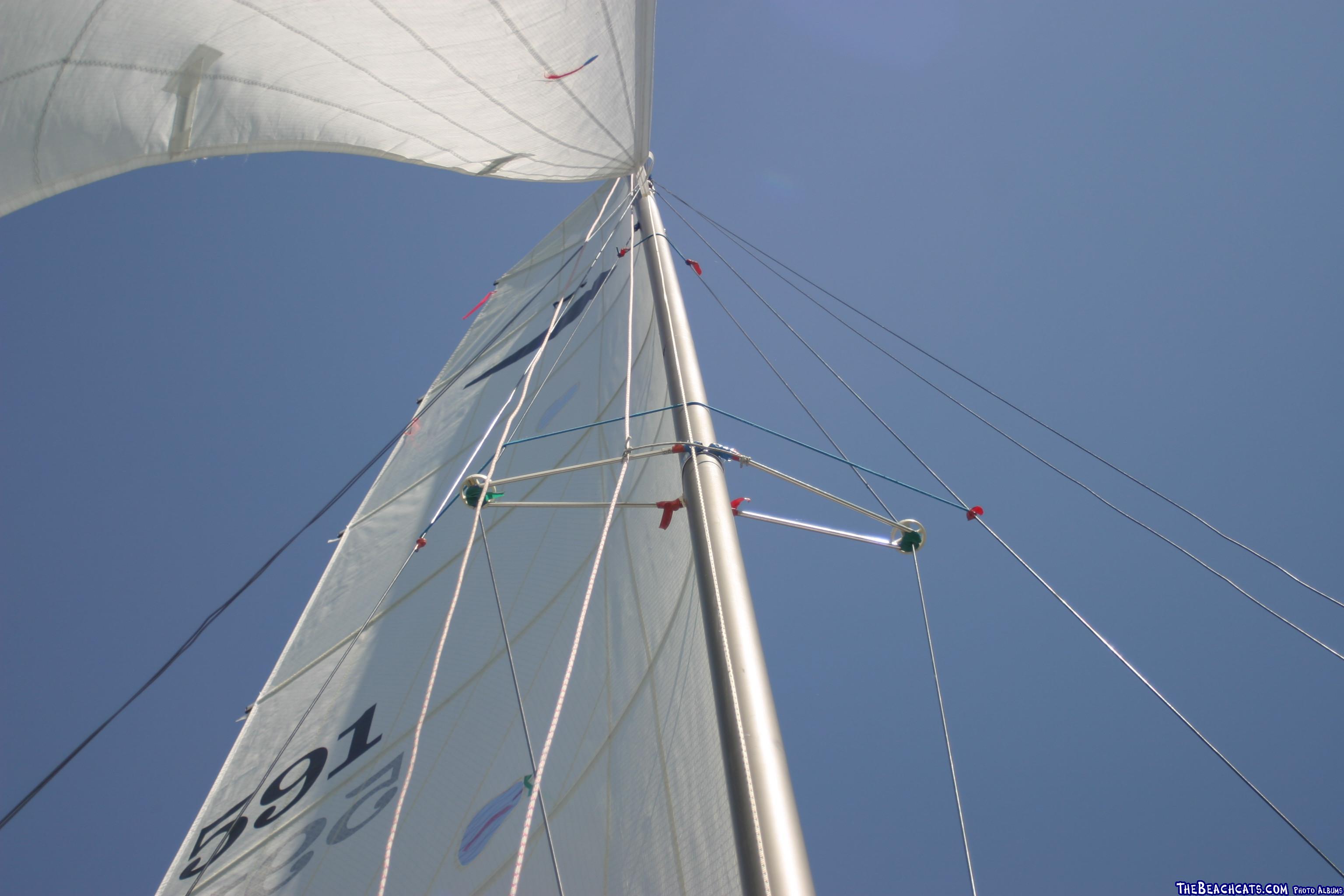

  • I'm assuming your setup is almost the same as my 6XL. Click photo to get the full size. This is identical to both my Nacras, with no issues.
    It is difficult to tape the top of diamonds as you have no room to get the tape underneath when winding. The Mystere uses heavy duty electrical shrink wrap. This leaves almost nothing to snag on, & the stuff lasts for ages, though you will have to undo the diamond to install it.
    Both my traps anchor as you have described. As long as the bungee keeps decent tension it has not been an issue.

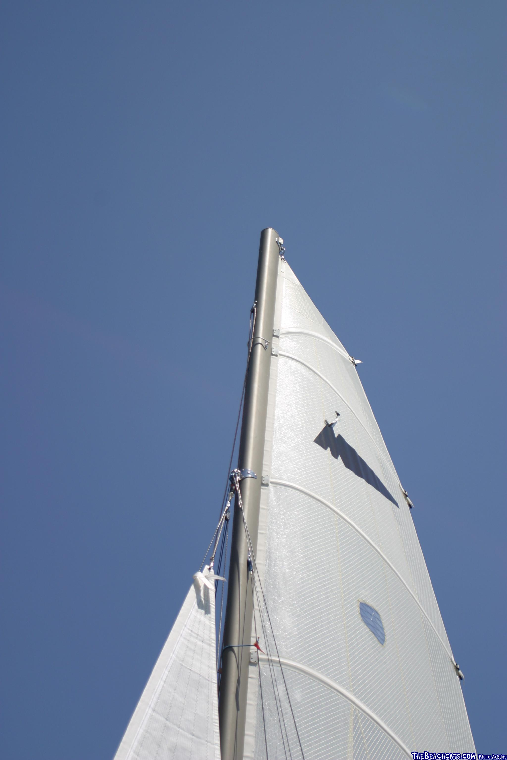

  • QuoteRun a bungee from shroud to shroud, trap wires and spin halyard on the outside. Problem solved.
    Good point Sam, I should have mentioned that. It is probably more effective than the heat shrink, here is how mine is rigged.There is a preventer on both the diamonds & the shrouds.
