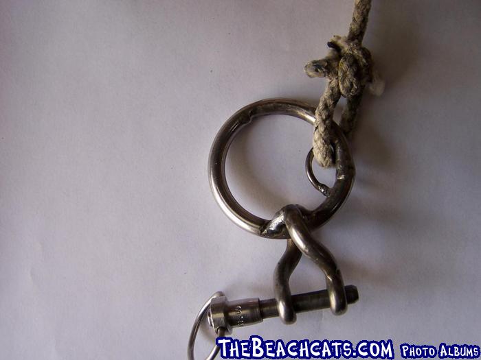

  • Here's the setup of the actual ring.
    http://www.thebeachcats.com/gallery2/main.php?g2_view=core.DownloadItem&g2_itemId=109248&g2_serialNumber=3

  • Andre, that is the exact ring I use on the 6XL.
    When I dry rigged the boat in the yard a couple times before bringing it to the lake, I could not get the sail off the hook either.
    Two things,
    1) Rather than tie the ring, as in your photo, dead end it onto the ring with a monkey fist or figure 8 stopper knot. As Pete said, keep the knot aft
    2) The shackle that goes onto the ring,(to attach the sail) is critical. My boat came with a heavy bow shackle on the ring, it proved impossible to work.

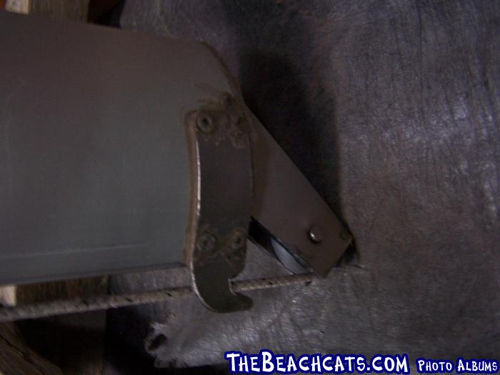

    I dropped the mast,(with sail on) leaving it attached at the base, & letting the top end sit on a tripod. I could then stand at the "top" & pull the halyard & see exactly what the problem was. As soon as I switched to a regular "U" shackle vs the heavy "bow", it unhooked everytime. I noticed the hook was bent slightly off center. Not sure if this is factory or a prang, but it means I must rotate the mast counterclockwise, then yank the halyard. Keep the mast rotated while the sail comes down the first few inches, then you can let it return to neutral. It works everytime, but the stopper knot orientation & shackle type were key.

  • Here's a homemade solution to the knot situationhttp://www.thebeachcats.com/gallery2/main.php?g2_view=core.DownloadItem&g2_itemId=109266&g2_serialNumber=4. By putting the knot to the side you eliminate the problem altogether. The ring slides up and over the mast hook and when it's time to let the sail down just pull on the main halyard.....turn the mast clockwise and down she comes. One caveat is the halyard must be to the right of the mast hook while raising.http://www.thebeachcats.com/gallery2/main.php?g2_view=core.DownloadItem&g2_itemId=109269&g2_serialNumber=4
