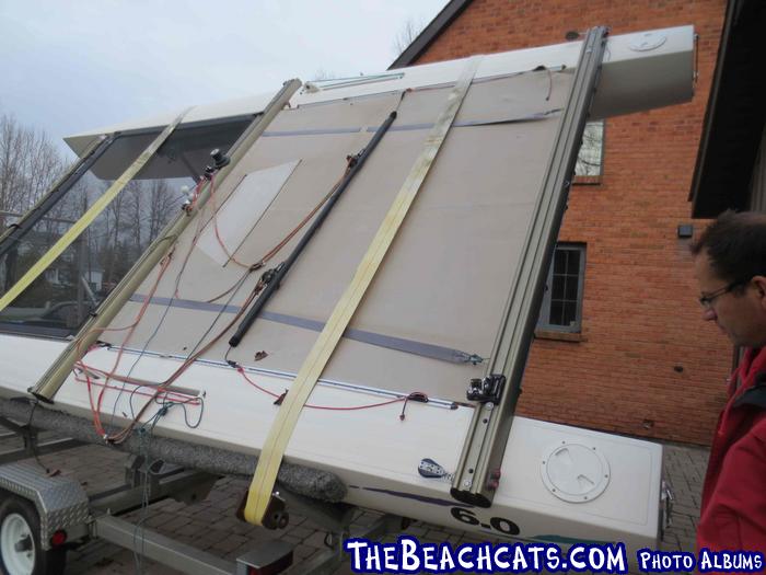

I have a massive front tramp on the 6 metre XL (10' beam).
It is open weave mesh, hardly shows in the photo. I'm sure it;s pretty wet. It goes full width, from the front beam nearly to the bows. It is a factory option, & on the 10' beam you had to have the small diametre cross beam to counteract the force from tightening the tramp
