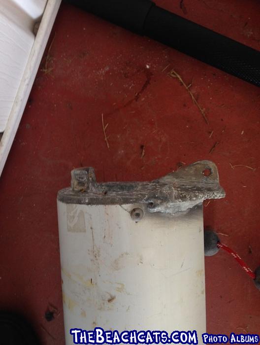

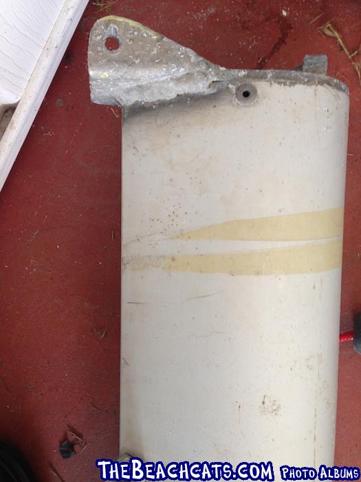

Hey guys,
I have a Prindle 16 (1984) with a broken mast pivot. It makes it very difficult to mount the mast (even with 3 guys!).
Do you guys have any ideas how to fix it? Welding? Will it hold?
P.S. will try to attach a picture
Mast Pivot

MrPrindle, Welcome to TheBeachcats.com,
What exactly is broken? Instructions for adding your own album for your pictures is in my signature below.
This is a common problem, parts are available.

Sounds like either the stainless hinge is broken or one of the flange (aluminum) holes on mast base has torn away. Pete -

Yup.
You need a new mast base.
Look for P16 parts here in the classifieds, or just contact pbegel via private message, as Pete stocks parts like this for sale and will ship.
Three rivets and you are back in business.
Your mast pivots dangerously raising and lowering without the two tabs on the mast base intact.
Don't get hurt or hurt someone else with that broken mast base.

Quick Update:
Mounted the mast on the catamaran yesterday, was very easy compared to last year without the mast base ;)
Installing the new mast base was quite easy (thanks pete!), but removing the old one was a pain....drilling out these old rivets was a pain and then the base was welded on the mast by the previous owner!!! Had to use a grinder to take it off.
